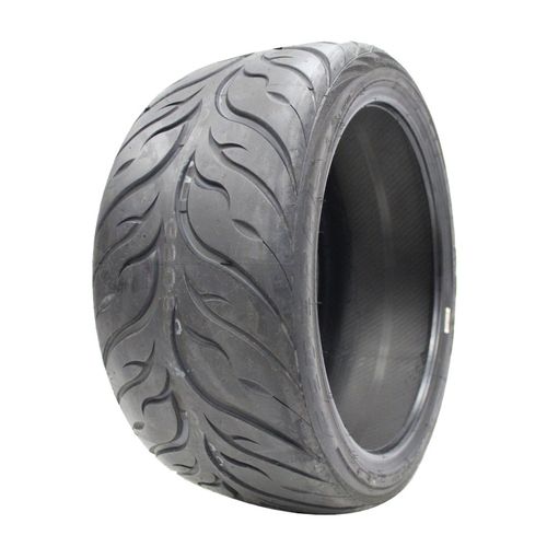

This is the tire I ordered.They were $140 a tire shipped
Susposed to be sticky and loud.
The 595ss I have now, pick up a lot of gravel at the end of the track.
