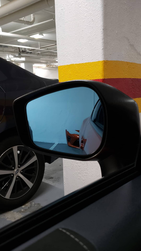

  • OLM wide-angle tinted side mirrors

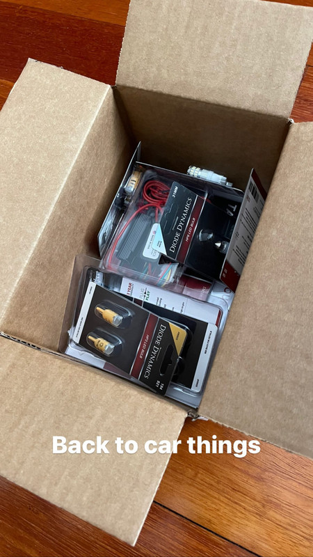

  • All non-LED bulbs converted to Diode Dynamics LEDs

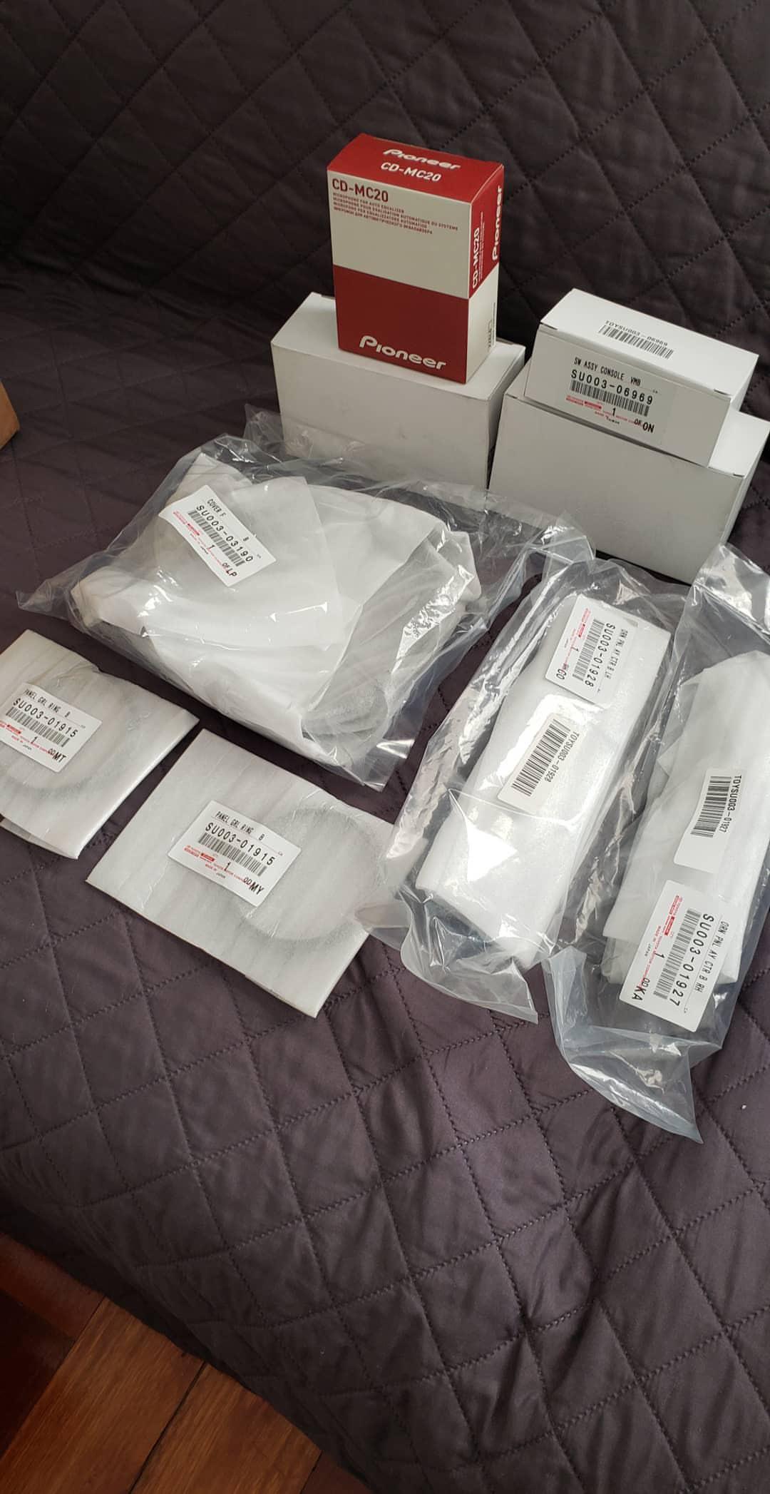

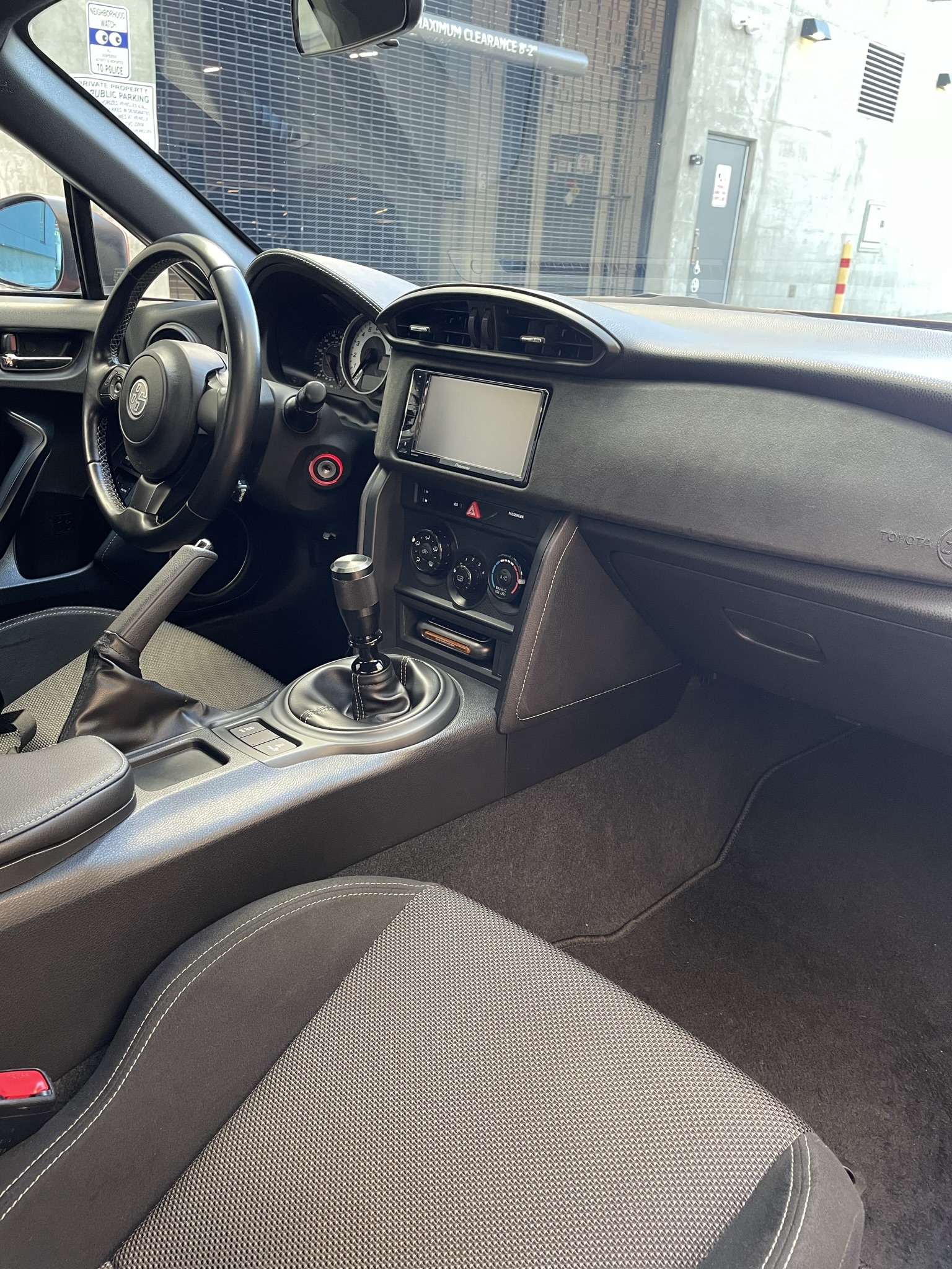

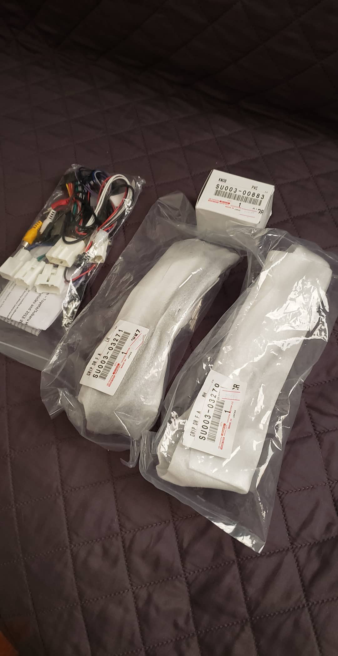

I actually had already begun purchasing some of the trickier parts to acquire beforehand, as I had certain things I didn't want to budge on. The hardest thing by far to get my hands on was the headunit, and I was going to tackle the interior of the car before moving outward anyway.

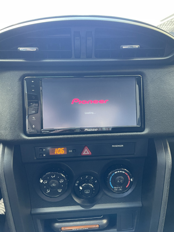

With the unusual 200mm sizing, I didn't want to compromise getting a standard double-DIN and stuffing it in with the side fillers that some people do. This is not a knock against doing so, but I wanted a headunit that fit completely flush purely for aesthetic reasons. In trying to stay as close to OEM as possible, I also wanted the components to be Pioneer, as the stock headunit is manufactured by them as well. Obviously also wanted CarPlay.
I specifically wanted a wired connection, as I was prioritizing sound quality for music and the added trickle charge of my phone simply being plugged in. I don't have my old computer with all my ridiculous Notepad files of endless lists of potential parts and such, but Kenwood had a good alternative I considered, but the AVH-ZL5150BT from Pioneer was the one that ticked all the boxes.

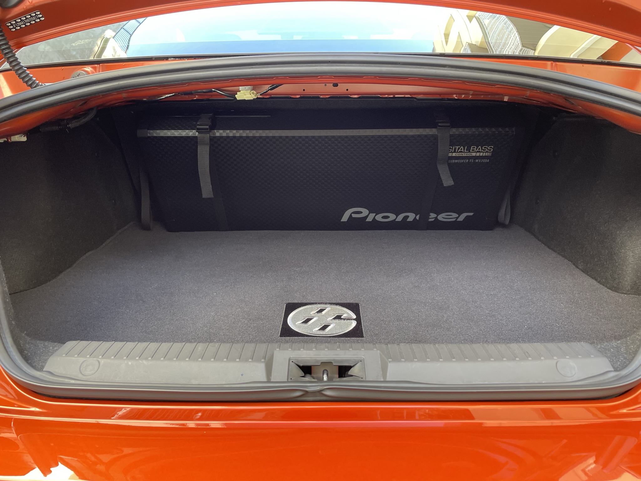

It took four months of contacting sellers from New Zealand, Australia, South Africa, Philippines, and Malaysia to find this headunit, but I tracked one down, and got an accompanying TS-WX70DA sub to keep it within Pioneer and add a little more thump to music without dedicating a large portion of my trunk to it. This sub is "ruggedized" as well, so in addition to allowing me to maintain folding down the rear seats if necessary, the encasing is meant to take a beating, so I wouldn't have to worry about scratches and such (I think it was advertised as a compact sub for trucks/SUVs).

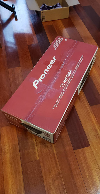

I did consider the OEM Subaru subwoofer for a while just to keep it "OEM," but this had two problems: one, the sub is by Kicker (again, I wanted to go all Pioneer for no reason besides consistency), and two, it couldn't be mounted 100% if you opted for the OEM trunk mat. Some people elect to kind-of mount it with the carpet mat anyway, but I just wanted everything to be as flush and as neat as possible.

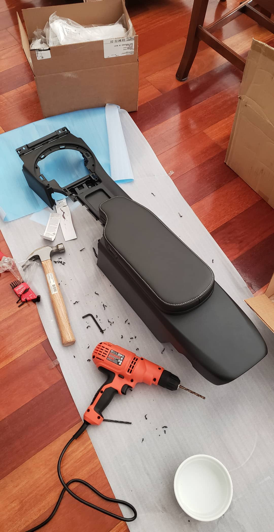

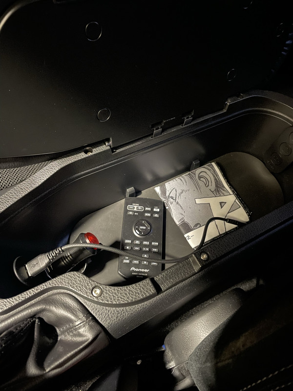

In the process of installing the headunit and armrest, I drilled another hole above the 9V in the center console to install a USB port. This allowed me to eliminate the USB/AUX plug at the front center stack (which I replaced with a blank cover) and have no cables showing.
The 9V which was never being used now powers the Govee interior lighting kit, as I was bored and didn't like having the plug empty/disconnected.
All steering wheel controls as well as the OEM backup camera work.
All of the interior trim pieces were gathered through sites like FTspeed, 86worx, and Japanparts. As listed in the initial post, only the shift knob and floor mats aren't OEM. I originally purchased the accompanying black JDM shift knob to match the rest of the interior, but disliked the plastic feel of the stock one to begin with, and this was just a different color version of the same thing. I used it for a bit, but ended up going with a much nicer weighted one. This in conjunction with the MTEC shift springs completely changed the shift feel, and I highly recommend the change to anyone considering doing something similar.

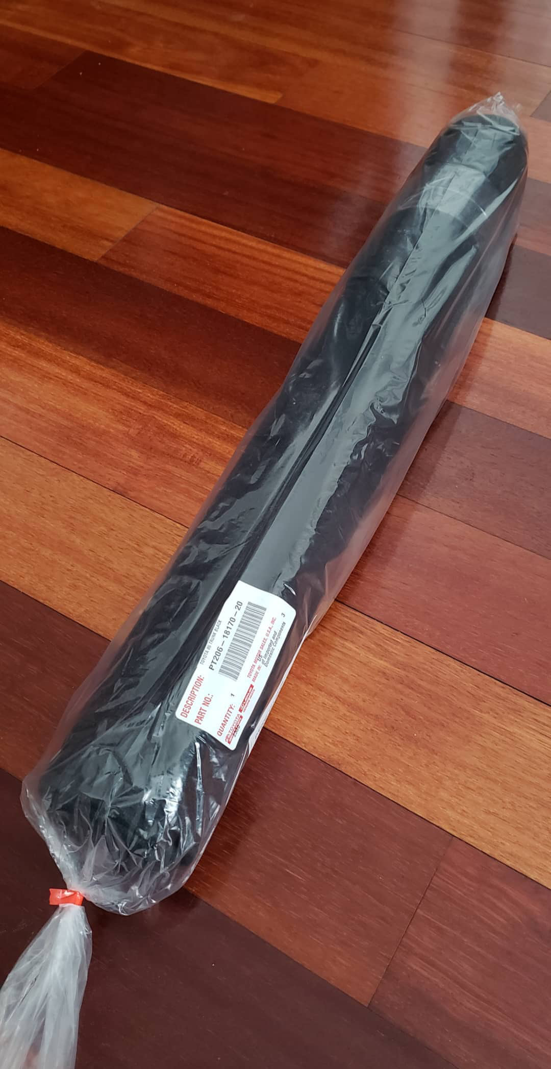

The original floormats that came with the car were the only weakpoint of an otherwise near-pristine car I bought, but I was murdering out the interior so much that I went and found some all-black ones to better fit the look. They lack the 86 circle badge on them, but I was unsure if I was going to completely re-do the interior at the time, so they were picked up and haven't been replaced.

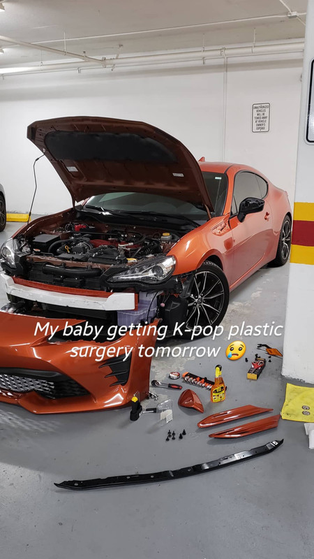

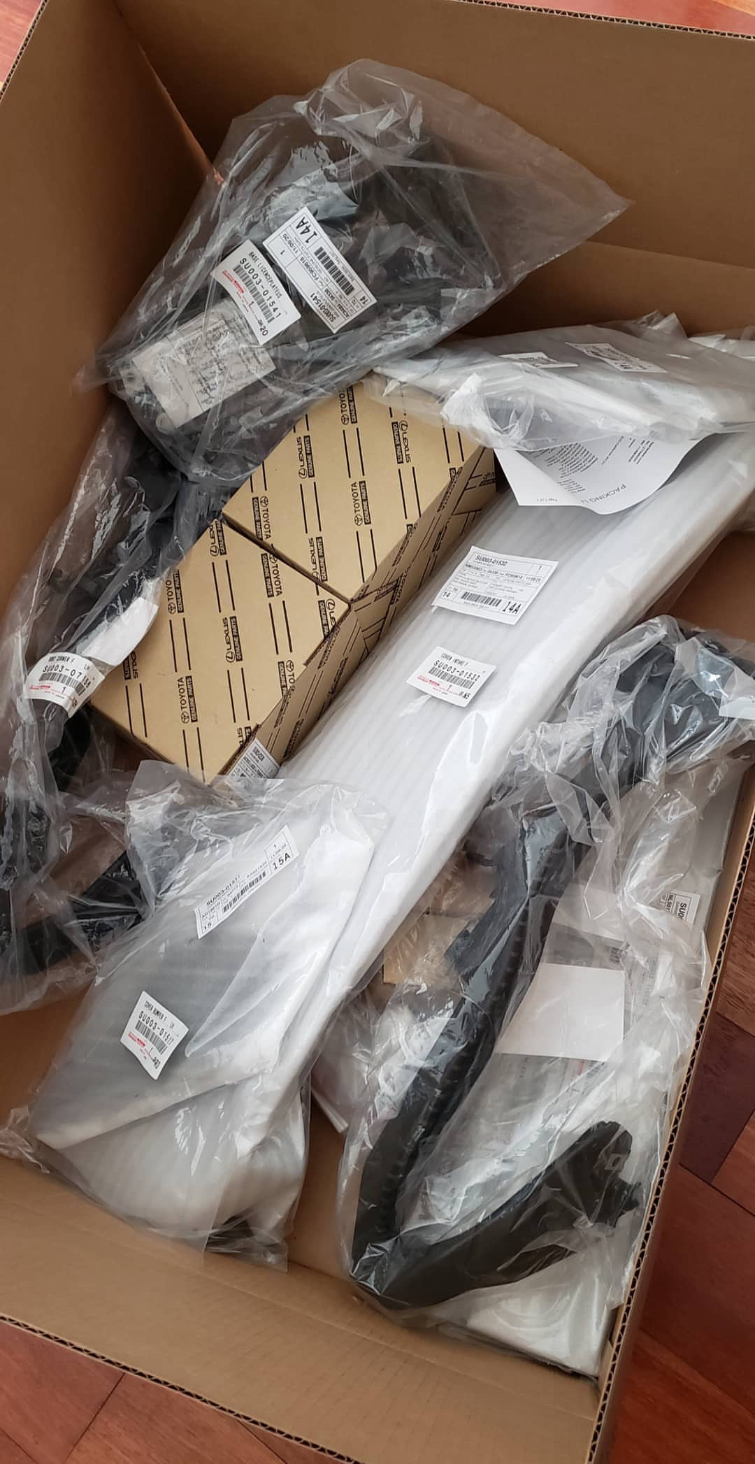

I spent quite a bit of time trying to figure out every part needed to do the front bumper swap, as no one had published a guide. Plenty had switched their old front ends to the facelift catfish bumper, though, so it was essentially doing the process in reverse.
The main takeaway was that the headlight brackets are incompatible between the two bumper covers. I ordered new parts for as much as I could, though, as I felt it was appropriate to replace everything to eliminate wear from the removal/installation.

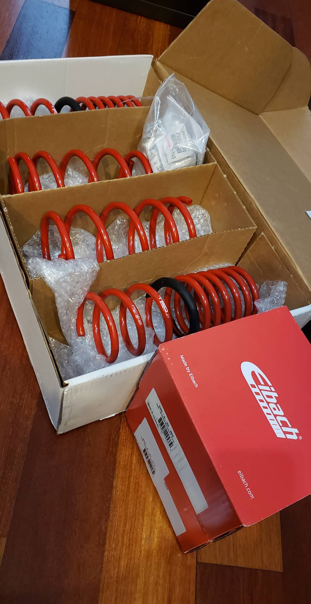

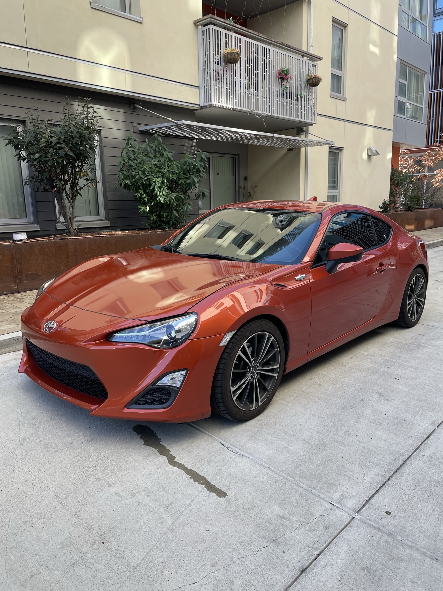

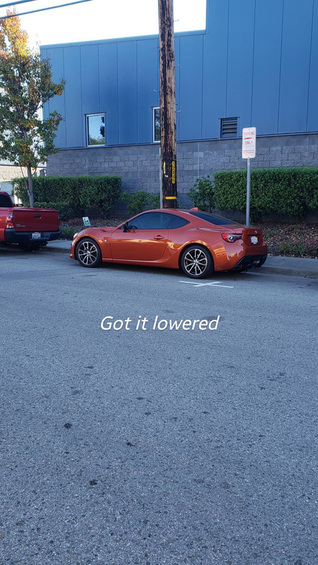

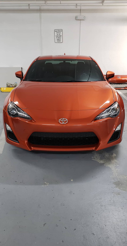

Before I got the bumper switched, I had the Eibach spacers and TRD springs installed; here's the last photo of my car with as the stock facelifted version:
Once the bumper along with the fender trims were painted and installed, I pretty'd up the car as much as possible before officially christening the car again with brand new Toyota/86 emblems!
Note the car still had the facelift wheels on at this point.

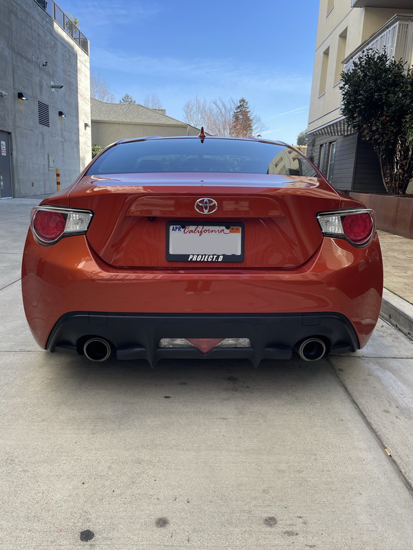

With the hard part out of the way, I only had two major things before the car was convincingly a zenki: wheels and tail lights.
What ended up happening first was the wheel swap. I was running the stock facelift wheels for a while, and on an errand with my buddy to go pick up his at-the-time new M2 Competition from being ceramic coated/clear bra'd, I got a flat from a huge nail on the side of the road:
In a ridiculously generous gesture, said friend found a set of beat-up FR-S wheels on Craigslist and brought them over to my place so I wouldn't have to roll around on a donut. I later swapped the tires that were on the FR-S set for better ones.

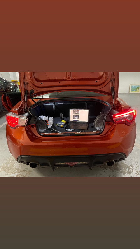

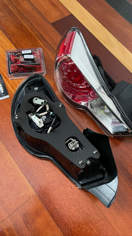

I found a local set of the old tail lights through a user on these forums, and picked them up shortly after the wheels were installed. I got Gasket Ninja replacement gaskets to ensure a good seal:

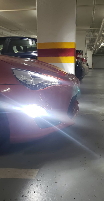

During this installation, I went ahead and switched all bulbs in the car that weren't LED, as I was installing the tail-as-turn kit from Diode Dynamics that would swap out the ones in the tail lights anyway. This included everything from license plate lights to the interior dome light.
Here's a snap with the old and new tail lights side-by-side:
The old tail lights get a lot of flak in the 86/BRZ community, but I personally adore round/circle tail lights. They're quintessentially "sports car" to me, and I didn't feel like I was retrofitting them just for the sake of consistency. Tail-as-turn is also a bit controversial for dedicating two indicators on to one light source, but at least it isn't another no-no that cops are looking out for.
