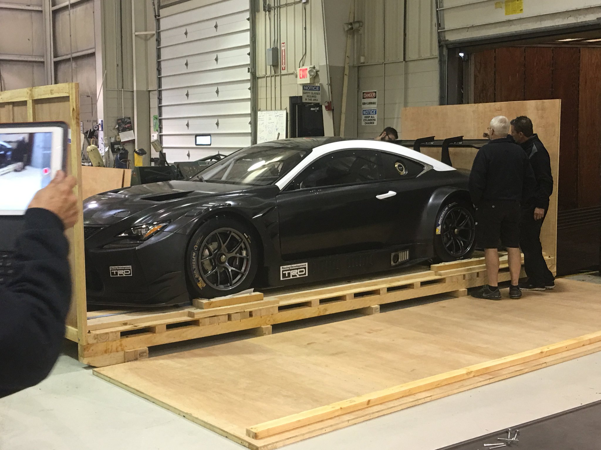

Lexus RC F GT3
Carbon body before wrapping...

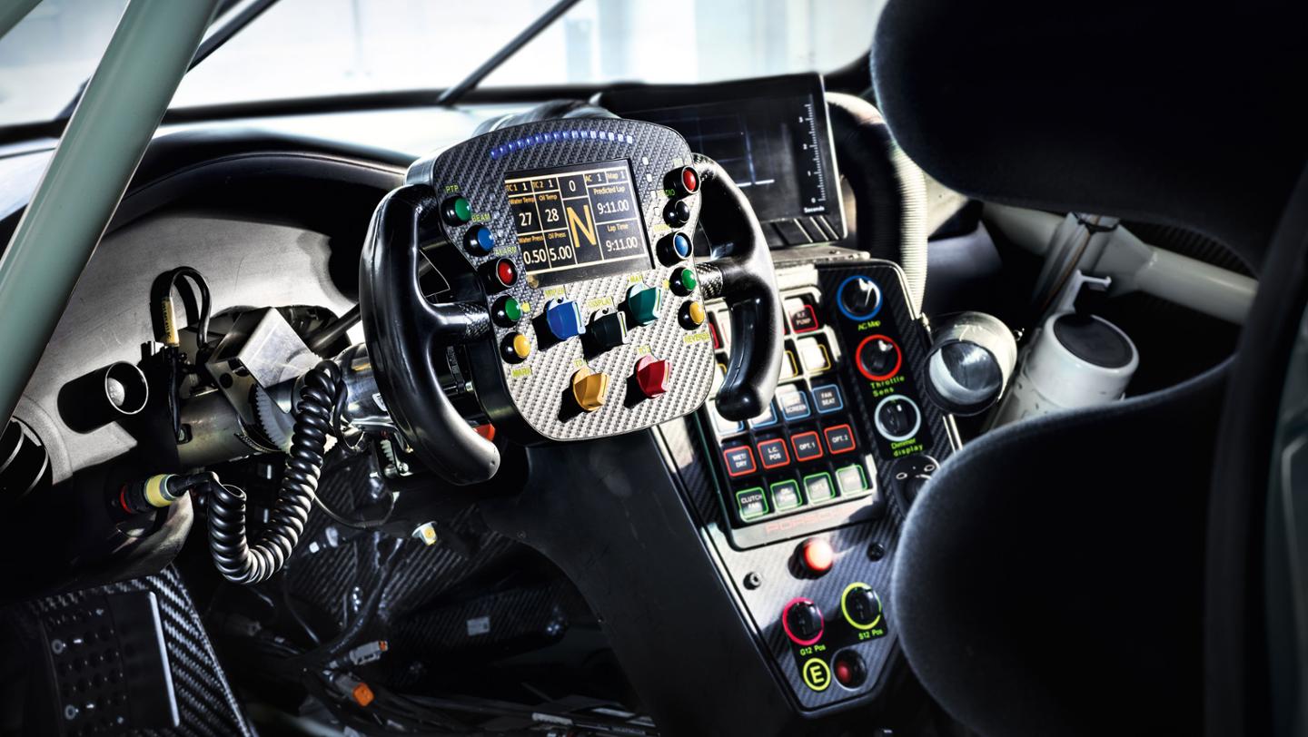

Porsche 911 RSR...took second in GTLM class last weekend.
Okay...you can't see the Radi-CAL brakes in this shot of the 911 RSR, but I just had to post it.

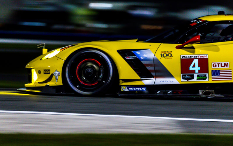

Corvette C7.R

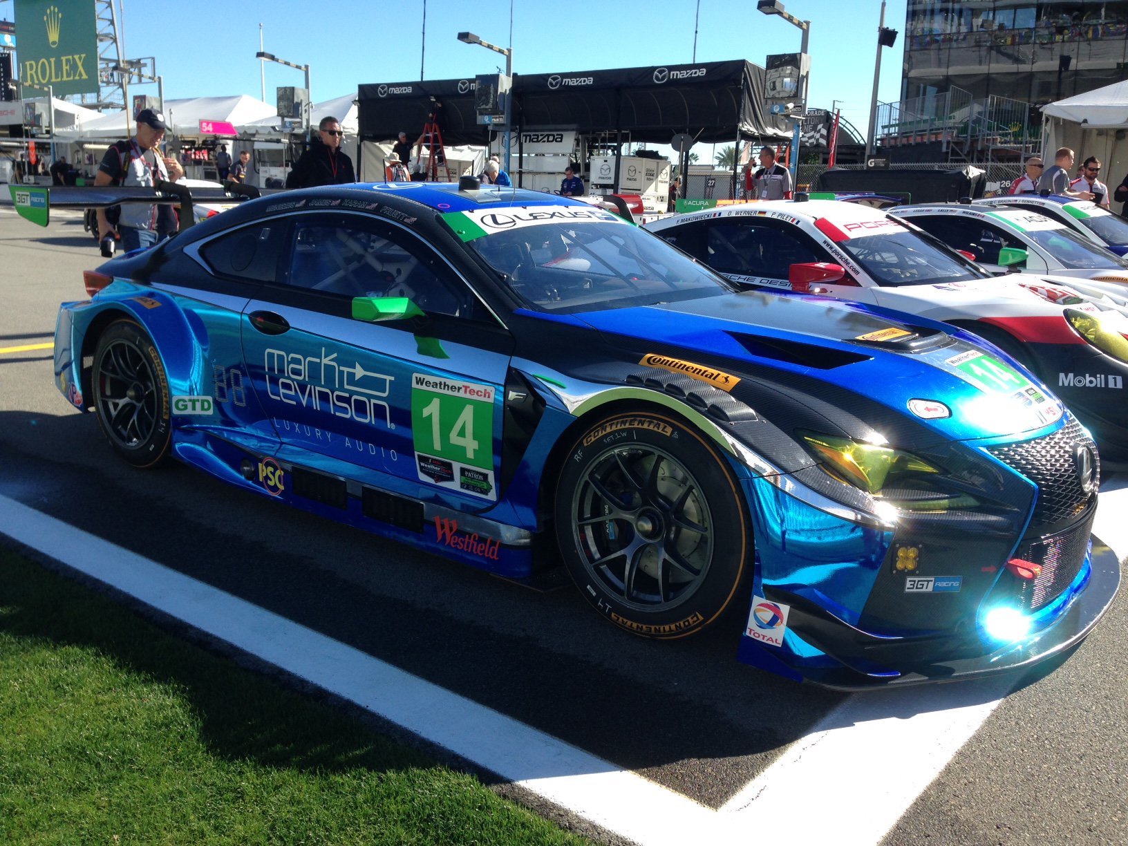

I was at the Rolex 24 too, but brakes were furthest thing from my mind, other than getting shots at the brake zone before the oval section:
Too bad the lexus team didn't do that well, pretty cars though. Still need to find time to sift through all the photos and video I took.

Sweet! I'm jealous...would have loved to have went. Nice pic!
