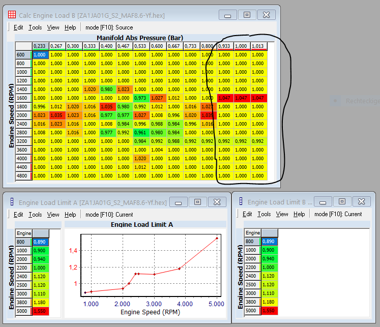

I justed wanted to share my experiences with the header install on my car (remember to think twice about safety if you think about modifying your rom):
Decided to keep my current tune (Stg. 1 with altered maf scaling etc.) and to update the missing bits. Went with the Stg. 2 EL cam maps and their corresponding ignition tables. I'm running 102 octane fuel, so there's an extra safety net.
The lower half of the rpm range felt great right from the start. I couldn't feel the torque dip any more. The engine pulled just linear from down low to top. Sound became great as well.
There are a couple of things I noticed:
  • I don't know if the Stg2EL maps were developed for a 4-2-1 or 4-1 header but they work well enough as a baseline for mine.
  • MAF scaling in the upper range was way off on the lean side (that's a good sign for a well working header). For safety purpose I enriched the table from 3.20V upwards by 2% before even firing the engine up. After warm up and some cautious logging it still ended up about 4% too lean! The irritations around the 60g/sec MAF range are gone. For the first time I had no issues re-scaling the MAF without excessive bumps.
  • The clean maf scale exposed an imbalance of the OEM DI/PI calibration on my car. The port injectors seemed to inject about 2.7% less fuel than necessary. This was obvious looking at the log data. I just picked some random AFR value out of said area and divided them through its AFR_CMD like this: 12.5/12.16=1.02796
In the next step I used this result as a multiplier on the Injector Flow Scaling table. The outcome is a mostly perfect-flat AFR curve.
Before:
After:
Now from this point onwards, I could go two routes:
A) adjust timing for my fuel and call it a day
or
B) get the necessary tools up and try to tweak the cam timing.

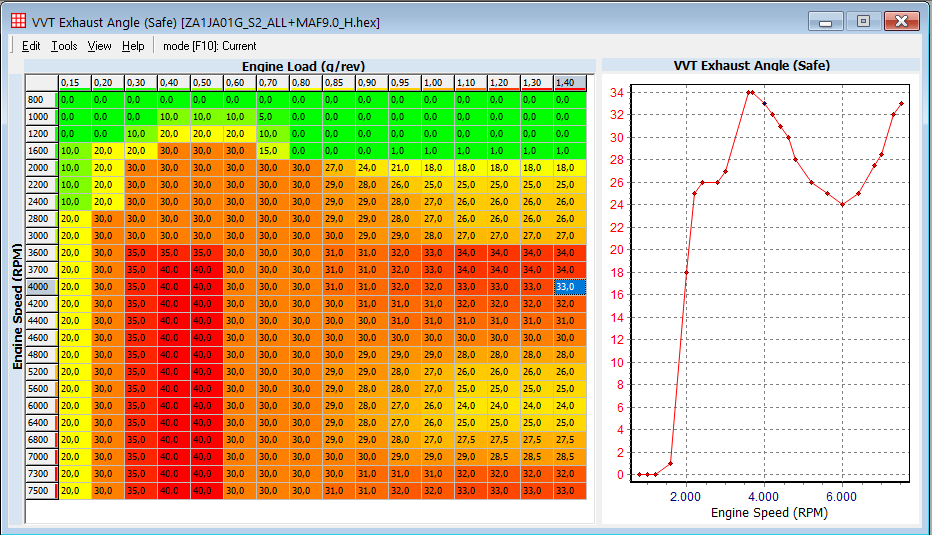

JDL EL 4-1
It's been a while since the OP. Unfortunately, I had to wait until the winter was over to get stable ambient temps.
Base maps were OFT v4, so the values in the 'cruise area' are original.
All the data in the tables about load 1.1+ have been determined with the help of vgi's mafscaling tool.
All values between cruise and wot have been smoothed manually.
I'm still concerned about the 4200 row in the exhaust table. It just looks wrong, but that's what the mafscaling tool came up with even after multiple tries to de-verify the results.
I've tried to use the highest gear possible, but most of the pulls were done in 3rd gear due to traffic and in particular because I don't want to hand out my driver's license.
I would not promise that I leave them in the current state, but here's a snapshot, nevertheless.
If anyone dares to test, please leave a comment here.
Code:
Exhaust retard:
,,0.15,0.20,0.30,0.40,0.50,0.60,0.70,0.80,0.85,0.90,0.95,1.00,1.10,1.20,1.30,1.40
800,0.0,0.0,0.0,0.0,0.0,0.0,0.0,0.0,0.0,0.0,0.0,0.0,0.0,0.0,0.0,0.0
1000,0.0,0.0,0.0,10.0,10.0,10.0,5.0,0.0,0.0,0.0,0.0,0.0,0.0,0.0,0.0,0.0
1200,0.0,0.0,10.0,20.0,20.0,20.0,10.0,0.0,0.0,0.0,0.0,0.0,0.0,0.0,0.0,0.0
1600,10.0,20.0,20.0,30.0,30.0,30.0,15.0,5.0,5.0,5.0,5.0,10.0,10.0,10.0,10.0,10.0
2000,10.0,20.0,30.0,30.0,30.0,30.0,30.0,25.0,20.0,20.0,20.0,20.0,20.0,20.0,20.0,20.0
2200,10.0,20.0,30.0,30.0,30.0,30.0,30.0,28.0,27.0,26.0,25.0,24.0,22.0,22.0,22.0,22.0
2400,10.0,20.0,30.0,30.0,30.0,30.0,30.0,28.5,27.8,27.0,26.3,25.5,24.0,24.0,24.0,24.0
2800,20.0,30.0,30.0,30.0,30.0,30.0,30.0,29.0,28.5,28.0,27.5,27.0,26.0,26.0,26.0,26.0
3000,20.0,30.0,30.0,30.0,30.0,30.0,30.0,30.3,30.4,30.5,30.6,30.7,28.0,28.0,28.0,28.0
3600,20.0,30.0,35.0,35.0,35.0,30.0,30.0,31.3,31.9,32.5,33.1,33.8,34.0,34.0,34.0,34.0
3700,20.0,30.0,35.0,40.0,40.0,30.0,30.0,31.3,31.9,32.5,33.1,33.8,35.0,35.0,35.0,35.0
4000,20.0,30.0,35.0,40.0,40.0,30.0,30.0,31.0,31.5,32.0,32.5,33.0,34.0,34.0,34.0,34.0
4200,20.0,30.0,35.0,40.0,40.0,30.0,30.0,30.0,30.0,30.0,30.0,30.0,30.0,30.0,30.0,30.0
4400,20.0,30.0,35.0,40.0,40.0,30.0,30.0,32.0,33.0,34.0,35.0,36.0,38.0,38.0,38.0,38.0
4600,20.0,30.0,35.0,40.0,40.0,30.0,30.0,31.5,32.2,33.0,33.8,34.5,36.0,36.0,36.0,36.0
4800,20.0,30.0,35.0,40.0,40.0,30.0,30.0,31.3,31.9,32.5,33.1,33.7,35.0,35.0,35.0,35.0
5200,20.0,30.0,35.0,40.0,40.0,30.0,30.0,30.0,30.0,30.0,30.0,30.0,30.0,30.0,30.0,30.0
5600,20.0,30.0,35.0,40.0,40.0,30.0,30.0,28.8,28.1,27.5,26.9,26.2,25.0,25.0,25.0,25.0
6000,20.0,30.0,35.0,40.0,40.0,30.0,30.0,28.6,27.9,27.2,26.6,25.9,24.5,24.5,24.5,24.5
6400,20.0,30.0,35.0,40.0,40.0,30.0,30.0,28.5,27.8,27.0,26.3,25.5,24.0,24.0,24.0,24.0
6800,20.0,30.0,35.0,40.0,40.0,30.0,30.0,29.6,29.4,29.2,29.1,28.9,28.5,28.5,28.5,28.5
7000,20.0,30.0,35.0,40.0,40.0,30.0,30.0,29.5,29.2,29.0,28.8,28.5,28.0,28.0,28.0,28.0
7200,20.0,30.0,35.0,40.0,40.0,30.0,30.0,29.3,28.9,28.5,28.1,27.8,27.0,27.0,27.0,27.0
7400,20.0,30.0,35.0,40.0,40.0,30.0,30.0,28.9,28.3,27.8,27.2,26.6,25.5,25.5,25.5,25.5

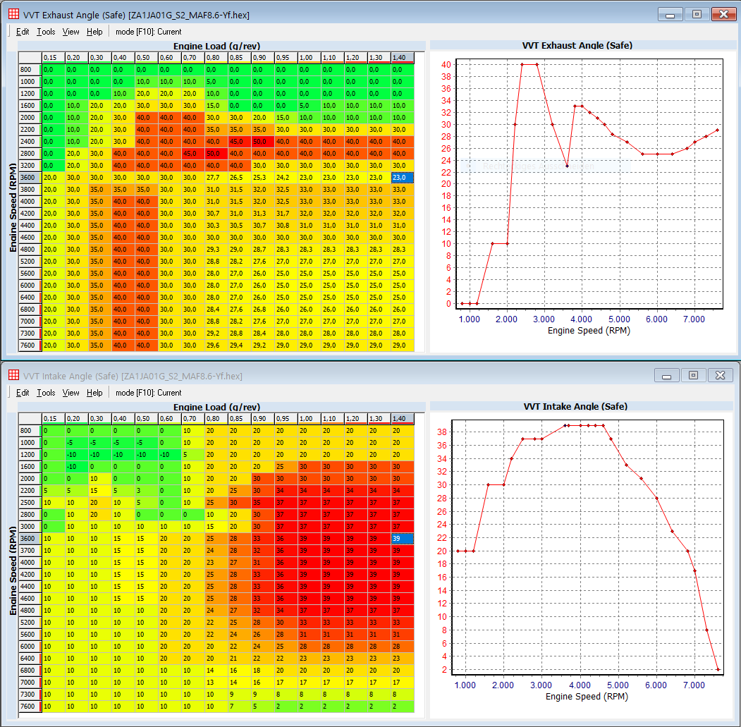

Code:
Intake advance:
800,0.0,0.0,0.0,0.0,0.0,0.0,10.0,10.0,10.0,10.0,10.0,10.0,10.0,10.0,10.0,10.0
1000,0.0,-5.0,-5.0,-5.0,-5.0,0.0,10.0,10.0,10.0,10.0,10.0,10.0,10.0,10.0,10.0,10.0
1200,0.0,-10.0,-10.0,-10.0,-10.0,-10.0,10.0,10.0,10.0,10.0,10.0,10.0,10.0,10.0,10.0,10.0
1600,0.0,-10.0,0.0,0.0,0.0,0.0,10.0,10.0,10.0,15.0,15.0,10.0,10.0,10.0,10.0,10.0
2000,0.0,0.0,0.0,0.0,0.0,0.0,10.0,15.0,17.0,20.0,20.0,20.0,20.0,20.0,20.0,20.0
2200,5.0,5.0,5.0,5.0,5.0,5.0,10.0,17.0,20.0,20.0,20.0,25.0,30.0,30.0,30.0,30.0
2400,10.0,10.0,10.0,10.0,10.0,10.0,15.0,22.0,26.0,29.0,32.0,36.0,36.0,36.0,36.0,36.0
2800,10.0,10.0,10.0,10.0,10.0,10.0,15.0,23.0,26.0,30.0,34.0,38.0,38.0,38.0,38.0,38.0
3000,10.0,10.0,10.0,10.0,10.0,10.0,16.0,24.0,28.0,31.0,35.0,37.0,37.0,37.0,37.0,37.0
3600,10.0,10.0,10.0,20.0,20.0,20.0,20.0,25.0,28.0,30.0,32.0,35.0,37.0,37.0,37.0,37.0
3700,10.0,10.0,10.0,20.0,20.0,20.0,20.0,25.0,28.0,30.0,32.0,35.0,40.0,40.0,40.0,40.0
4000,10.0,10.0,10.0,20.0,20.0,20.0,20.0,25.0,28.0,30.0,32.0,35.0,40.0,40.0,40.0,40.0
4200,10.0,10.0,10.0,20.0,20.0,20.0,20.0,24.0,27.0,29.0,31.0,34.0,38.0,38.0,38.0,38.0
4400,10.0,10.0,10.0,20.0,20.0,20.0,20.0,24.0,26.0,28.0,31.0,33.0,37.0,37.0,37.0,37.0
4600,10.0,10.0,10.0,15.0,15.0,20.0,20.0,24.0,26.0,28.0,31.0,33.0,37.0,37.0,37.0,37.0
4800,10.0,10.0,10.0,10.0,10.0,20.0,20.0,24.0,26.0,28.0,31.0,33.0,37.0,37.0,37.0,37.0
5200,10.0,10.0,10.0,10.0,10.0,20.0,20.0,24.0,26.0,28.0,30.0,32.0,36.0,36.0,36.0,36.0
5600,10.0,10.0,10.0,10.0,10.0,20.0,20.0,23.0,25.0,26.0,28.0,30.0,33.0,33.0,33.0,33.0
6000,10.0,10.0,10.0,10.0,10.0,20.0,20.0,22.0,24.0,25.0,26.0,28.0,30.0,30.0,30.0,30.0
6400,10.0,10.0,10.0,10.0,10.0,20.0,20.0,22.0,23.0,24.0,24.0,25.0,27.0,27.0,27.0,27.0
6800,10.0,10.0,10.0,10.0,10.0,10.0,10.0,12.0,13.0,14.0,16.0,17.0,19.0,19.0,19.0,19.0
7000,10.0,10.0,10.0,10.0,10.0,10.0,10.0,12.0,12.0,13.0,14.0,14.0,16.0,16.0,16.0,16.0
7200,10.0,10.0,10.0,10.0,10.0,10.0,10.0,10.0,10.0,10.0,11.0,11.0,11.0,11.0,11.0,11.0
7400,10.0,10.0,10.0,10.0,10.0,10.0,10.0,10.0,9.0,9.0,9.0,8.0,8.0,8.0,8.0,8.0
PS: don't look at the numbers

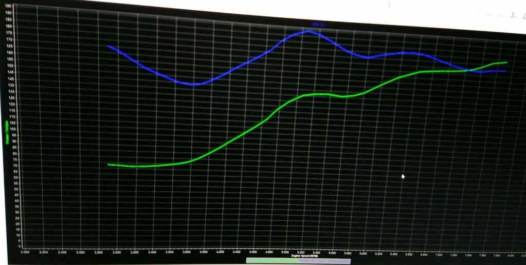

Small update
Cam maps updated. Power is much better in the lower rpms and the transition from cruise to WOT.
I actually had to pull some percent out of the first third of the DBW torque request maps to not run into drivability issues.
There are some improvements in the last thousand revs as well!
PS: The latter vdyno pic is from an old run with the stock header. Found it somewhere on my hard drive. Felt like posting it for a good laugh.
