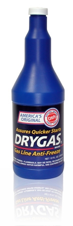

stevesnj
stevesnj's Avatar
Drives: 2016 FR-S Oceanic Blue
Location: Southern NJ
Posts: 2,958
Thanks: 2,158
Thanked 1,601 Times in 923 Posts
Also try this stuff. Works great! I use this in my truck because i don't keep the tank topped off.
My 2016 Build thread
TRD Exhaust with custom quad tips, TRD Lowering Springs,TRD Quick shifter,LED;DRL, Projectors, and turn signals. Re-badge, 86 Nanny, WinmaxW2 Pads, K&N Drop In, Antenna delete

As others have said, Water in the gas. Toss a bottle of heat in it along with fresh gas as often as you can to get the water out of it.
