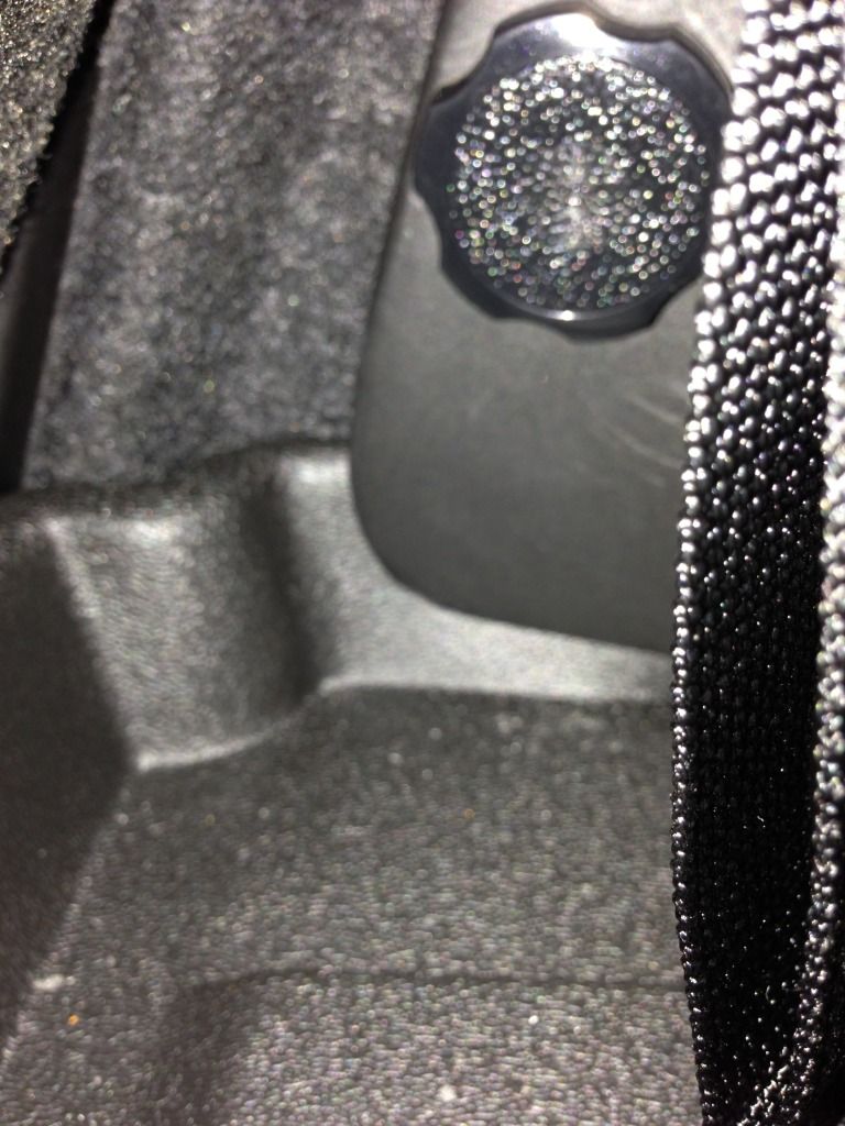

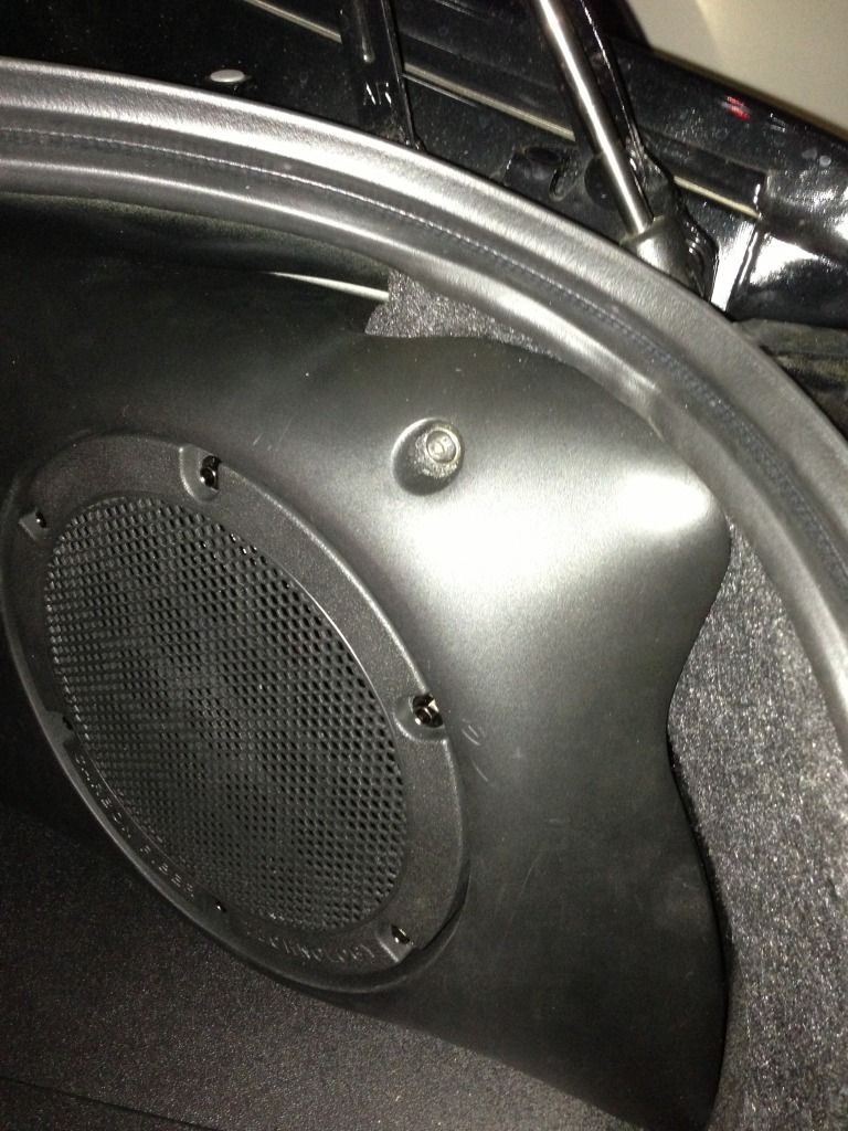

The 19 lb woofer with attached amp takes about 20 seconds to remove.
Keep the provided Allen key in your glove box for easy removal. There is one screw at the back that the Allen key can remove and the other screw just behind the rear seats has a handle type screw for even easier removal.
You would need to unscrew those two screws to get the spare tire out. Again it wouldn't take any time.
I will take some pictures of what I'm taking about for you.

Here is the Allen key screw.
And here is the hand one. You can see the seat pull strap for reference on where this sits.
