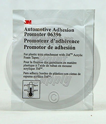

And don't forget to use this first....
https://www.amazon.com/gp/product/B0...?ie=UTF8&psc=1
