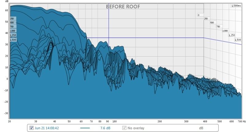

The bottom line is, distortion is caused by excursion. Its true that a well designed speaker will have more excursion before distortion becomes audible, but its also true that a larger cone won't need to move as much for the same output/frequency, which will lower distortion.
Speed, when referring to sound, is about a speakers ability to handle transients. This comes strictly down to motor strength vs cone mass vs suspension stiffness. If a larger speaker sounds "slower or lazy", that's because it needs more motor strength.
Poor tuning will also cause a subwoofer to sound slow or lazy. Being out of phase with the midbass will cause this. Having the level slighty high will also cause this.
Another thing that can case this, as well as poor decay, is poor sound deadening. This causes the metal panels to continue to ring for as much as a second after the initial impulse. That causes smearing.
This is the decay plot of a car that has been fully deadened except for the roof. Notice how frequencies continue to resonate as long as 1.5 seconds.
This is the same car, with the roof deadened. Notice how much quicker the initial impulse decays, leading to a much more accurate bass sound.
