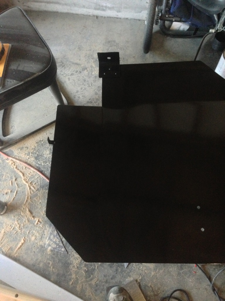

Hey guys! So, I'm not an engineer or anything, just a self educated hobbyist and diy'er. I hate to see issues on my cars that could be fixed with a few hours and a hundred bucks.
I also hate to see fake or nonfunctional parts on cars. Our "rear diffuser" drives me nuts and in my opinion, it's a critical piece of both performance and visual on a sports car.
Here is my baseplate/prototype/version 1 of my diffuser for my car. I haven't riveted on the vanes for channels yet. The "R" cutout is to clear my Perrin exhaust, the front tabs bolt in the lower bolts on the rear sway bar, this closes nearly the entire open space in the rear bottom bumper and extends about 2 inches past the rear of the car. It doesn't follow the lines of the fake diffuser on the bumper, instead it creates a clean line on the bottom, where the OEM additional "diffuser" bolts on. Putting the exhaust inside of the air free cavity.
I built a similar panel for my 2006 eclipse using the tissue paper "tabs" and a gopro for testing.
It isn't close to finished, I'm doing a wrinkle coat black on the top and I'm planning on a gritted bed liner or flat black on the road side. Might leave it bare aluminum, haven't decided. This one is all built and bent by hand. Once I'm done tweaking, I'll do a nice laser cut one and anodize or powder coat it.
Attachment 35353
Attachment 35354
Attachment 35355
Attachment 35356
Attachment 35357
Attachment 35358
Attachment 35359
I am very impressed...very fine and functional I assume. It seems similar to TRD one.
A question: can you install and drive without registration on car paper, safety issues? It' road legal in your country? thx
