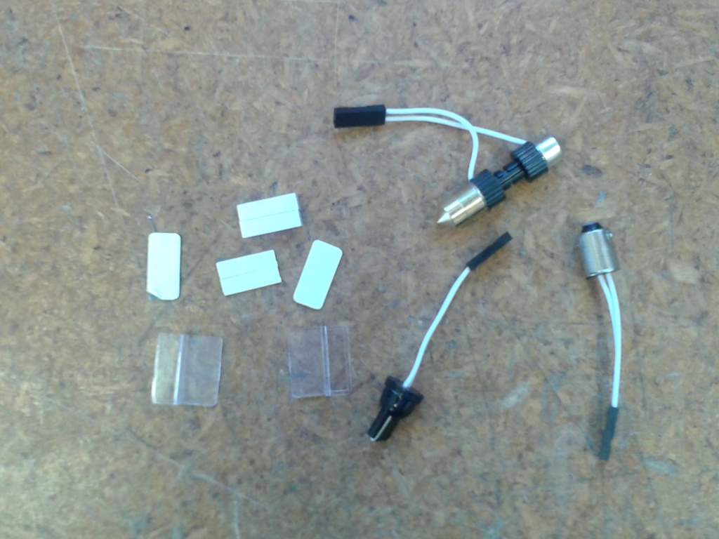

On this one, there are a couple of short wires attached to a 2 pin connector.
It also came with a selection of adaptor connectors. None of which we need, but we do need the female part on the connector off one of the adaptors. Cut the 2 pin connector complete with as much wire as there is attached to the connector, because we will need to lengthen them.
Attachment 128735
Notice there are some clear plastic mounts and some double sided sticky foam in this kit. These will be used to mount the light.

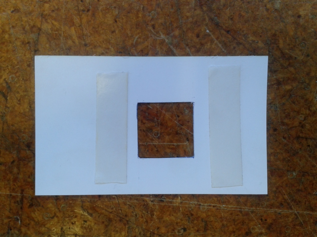

First we need to make a template for the square hole that needs to be cut. this is easy enough by tracing around the LED light onto a piece of card. Then carefully cut out the square you have just drawn.
Attachment 128737
Attach a couple of pieces of double sided tape to the template as seen in the picture and then put aside for now.

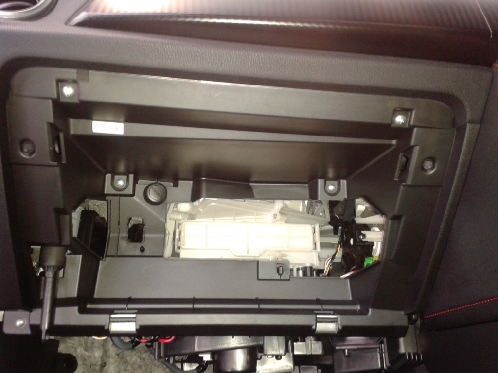

Remove the 5 screws from the corners of the interior seen in the following picture.
Attachment 128738
I was not able to remove the glovebox completely. Something else is holding it in there, but it is able to be moved enough to see where the light needs to be placed. Fortunately there is a lot of empty space above the glovebox.

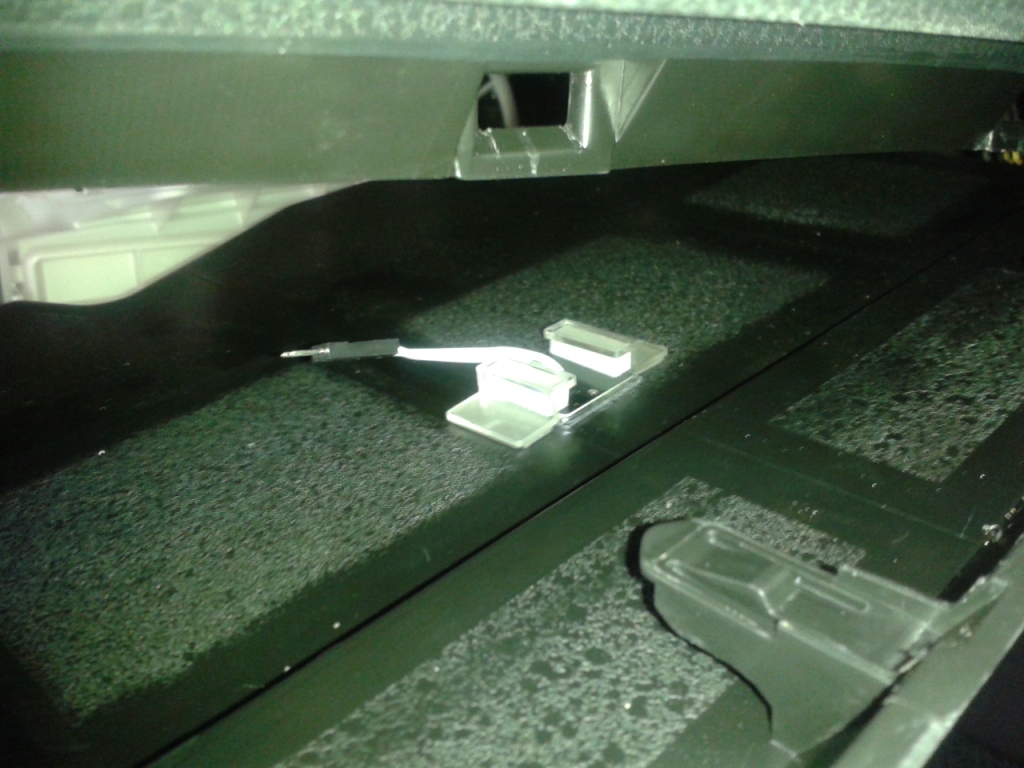

Attach the plastic mounts and sticky pads to the LED light.
Attachment 128739

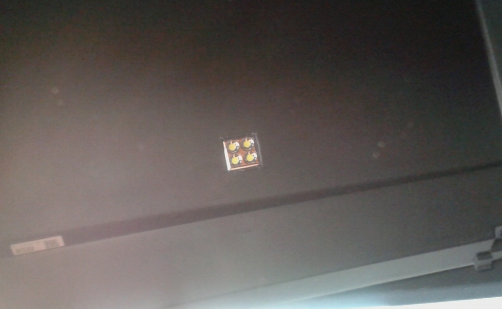

Expose the sticky pads and fit the LED into the hole from the top.
Attachment 128740

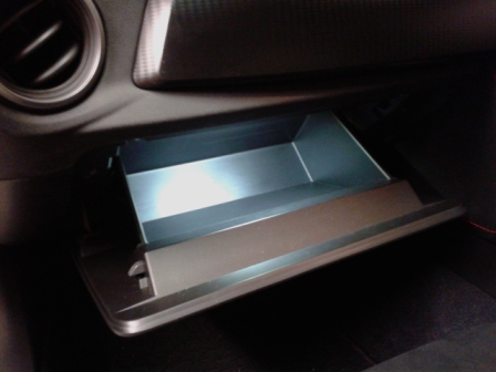

How it looks from the bottom.
Attachment 128741

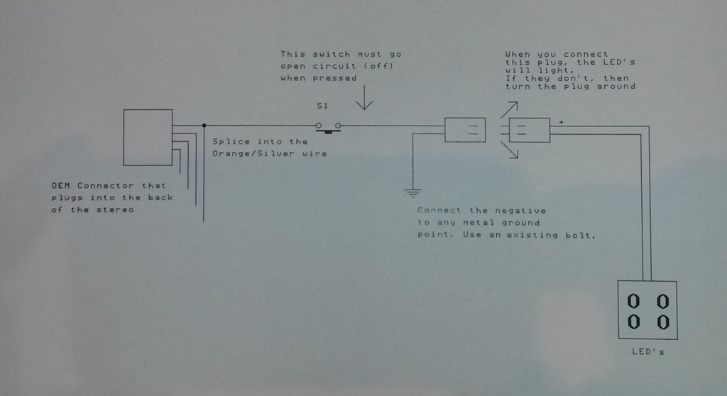

Here is the circuit diagram of how it will be connected.
Attachment 128742
You need to buy a "MOMENTARY" push switch where the switch contacts OPEN when the switch is pushed and CLOSE when it is released.

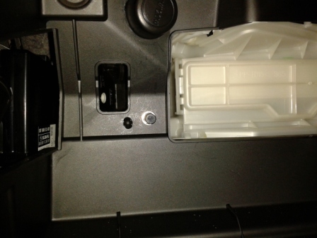

Drill a hole for the switch in the place shown in the next picture. Use the pollen filter as a guide. Note: on a LHD car the position may be mirrored to what you see here. I don't know.
Attachment 128730

Before fitting the switch, attach two wires to the pins. One needs to be long enough to reach the back of the stereo and the other needs to be attached to the female socket that plugs into the LED lamp. The second wire of the female socket needs to go to a metal earth point using a convenient bolt close by.
Refer to circuit diagram before connecting! I used heatshrink tubing over each connection. At the very least, use insulation tape so no live connections are exposed.

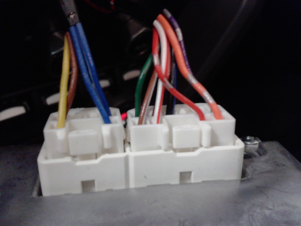

Remove the stereo and unplug the connectors to it to allow room to work. The switch wire needs to be connected to 12V+. In my case, this is the Orange wire with silver tracer.
AGAIN NOTE, the wiring on USA cars may be a different colour so before connecting, temporarily reconnect the battery and test for a live 12V+ wire with everything turned off. TEST AND CONFIRM! Then disconnect battery.
Attachment 128731
Once all connections have been made AND INSULATED, connect the battery and the light should work. If it doesn't, then swap around the LED plug as LED's are polarity sensitive. Press the switch and the light should go out. (if you haven't used the switch option, then the LED'S should light when you turn on your park lights)

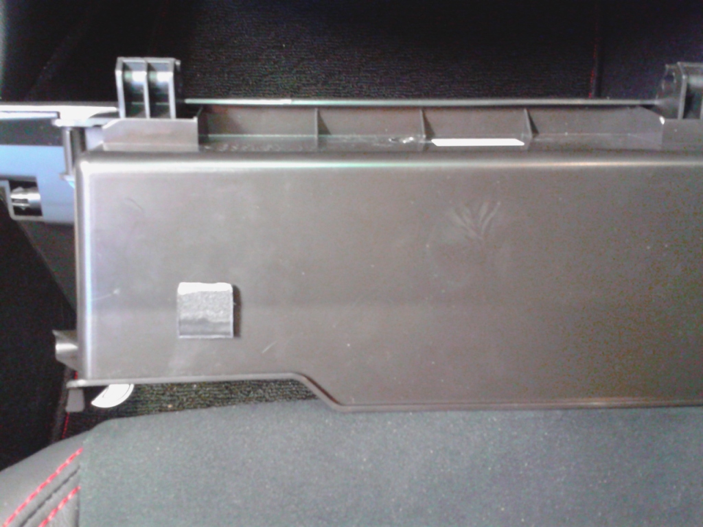

The switch I used was not quite long enough to active when the door closed. I used the square piece of plastic I cut out for the light and attached it with double sided adhesive foam to the back of the glovebox door. This pushes on the switch actuator when the door closes. If you look through the missing dashboard panel you should be able to see the light go off when the door closes.

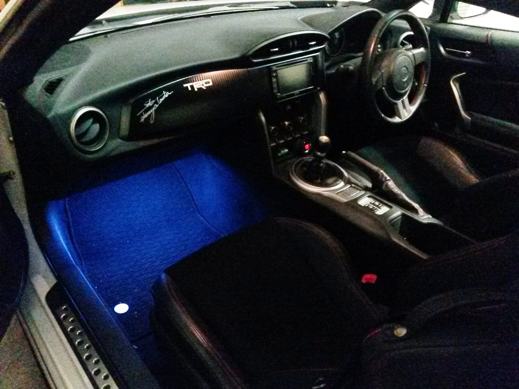

I have these all over my interior in red so that you get some glow but don't lose your night vision. One in each footwell, on3 in the glovebox and several in the trunk. Inexpensive, non-permanent and throw out a nice amount of light.
https://www.superbrightleds.com/more.../attributes/13
For power I just used a barrier terminal block and daisy chained all the terminals together off of the dimming wire going to the stereo head unit. In the trunk I tapped off the +12V to the tail lights.

Yes I have also done the footwell thing with LED strips. They work independently, so each footwell lights according to which door you open.
Also replaced the OEM trunk light and licence plate lights with plug in LED equivalents.
