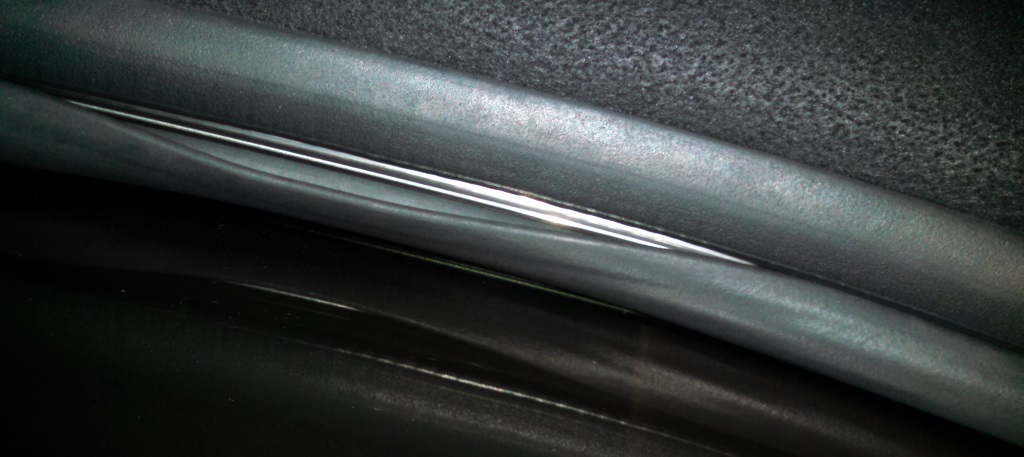

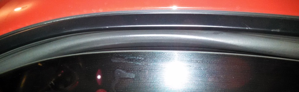

Wondering if any of you have had this and fixed it yourself.
"Drivers window grabbing window seal and pushing it up."
I'm no longer in warranty and the guy at the dealer has never hear of the issue, nor is he really any help aside from wanting to charge me $ for service I can do myself. So far I haven't had any leaks but on the rare occasion the window doesn't go all the way up, which I have to push the window button to get it to go up the rest of the way.
All I really need is a list of parts I need to replace. Ideally I'd like a DIY forum post with pictures but beggars can't be choosers.
Thanks :)
Door open
Attachment 127574
Door closed pic from inside looking up
Attachment 127575
Door closed pic from outside vehicle
Attachment 127576
Door slightly open
Attachment 127577

@humfrz & @Tcoat I added some pictures to the first post. Cleaning the window and weather strip didn't help.
Tcoat 12-20-2015 07:17 PM
Oh that is nasty! Should have been warranty for sure but too late now. I think replacement is certainly in order.

humfrz 12-21-2015 01:06 AM
Yep, I agree ...... @stockysnail that is beyond "fixing" with a blow dryer or slicking up with silicone.
Weather stripping should be replaced.
Then, I suggest, you slick it up, to minimize the chance of it happening again.
