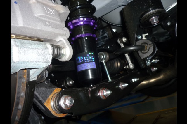

Thoughts on this suspension system? A little over $1,000 including shipping on eBay Attachment 9137Attachment 9138Attachment 9139

Not looking to bash someone's product, but you did ask for opinions. expect damping "lines", not damping "curves" if you ever put them on a shock dyno. Expect springs of irregular resistances levels, and expect each shock to dyno a little differently. And "adjustment knobs" that don't really do anything.
I suspect they took a generic damper from another chassis and put it into a jig for the FRS. (bad as it wasn't designed with the motion ratios or weight of the FR-S) valving is likely not specific for this car, and is cheap valving anyway.
If you are looking for improved performance don't buy these. If you are looking to be able to lower your car, then these are an ok option i guess. If you want to be lower with some performance increase on a budget, maybe put some lowering springs on the stock dampers. The stock dampers are actually pretty good, and you'll save money.

I've ran these shocks on a dyno, and they're pretty good for the money. Don't expect Bilstein performance, but for that price they're not bad. Digressive curves, damper adjustment knobs actually do something, and each damper was within 5% of each other which is pretty much the industry standard for mass produced shocks afaik. I haven't ran the FR-S shocks on a dyno, but I've ran several other D2 shocks on a Roehrig 2VS. <5ips looked good; >5ips was decent. These shocks have done well at the national time attack level.
I wouldn't put them on my FR-S, but if we were talking about a 20 yr old 240SX or Civic that's got stock suspension, sure. The bushings, damper internals, and springs are all still in great shape on your car.
KW would be a great choice, if you can afford them. If not, then D2, BC Racing, or Megan racing would be fine. Fortune Auto would be my choice in the $1000 range though.
