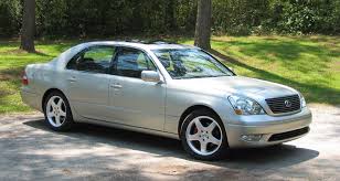

joe strummer 10-22-2015 01:06 AM
Engineering
https://encrypted-tbn0.gstatic.com/i...4_qxmkKZHeylJ8https://encrypted-tbn3.gstatic.com/i...JaHRs-9Rg9GQ-A
Interesting, the LS430 has a lower coefficient of drag than does the FR-S, 0.26 vs 0.27.

joe strummer 10-22-2015 01:34 AM
Originally Posted by humdizzle (Post 2427875)
you have to factor in the frontal area too. scroll down to drag area on that page. thats a better representation of how 'aerodynamic' a car is. Cd only tells part of the story. '
So assuming the Lexus has a larger frontal area than the Scion (sure looks like it), it has more drag at a particular speed than the FR-S does at the same speed?

joe strummer 10-22-2015 01:53 AM
Very interesting. Thanks.
However, Wiki has this formula for drag coefficient-
https://upload.wikimedia.org/math/2/...dd50316ea8.png is defined as:
https://upload.wikimedia.org/math/7/...b3504a67a1.png where:
https://upload.wikimedia.org/math/a/...ee64a72d01.png is the drag force, which is by definition the force component in the direction of the flow velocity,https://upload.wikimedia.org/math/a/...20d960811a.png is the mass density of the fluidhttps://upload.wikimedia.org/math/6/...c042b427ef.png is the flow speed of the object relative to the fluid,https://upload.wikimedia.org/math/7/...88396b7f5c.png is the reference area.
It appears that (frontal) area is already calculated into the result. So, although the FR-S may have a smaller frontal area than the LS, its drag coefficient is higher, and therefore its total drag at a given speed is higher than the LS.
What am I missing?
