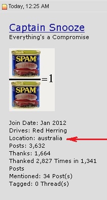

Captain Snooze 09-29-2015 01:25 AM
Originally Posted by Chase1996 (Post 2404467)
what do you mean by dB?? and you are saying they arent legal in the states?
dB is abbreviation of decibels. Decibels are often used to express sound pressure level. That is, loudness.
No, I don't mean the states.
Attachment 121415
