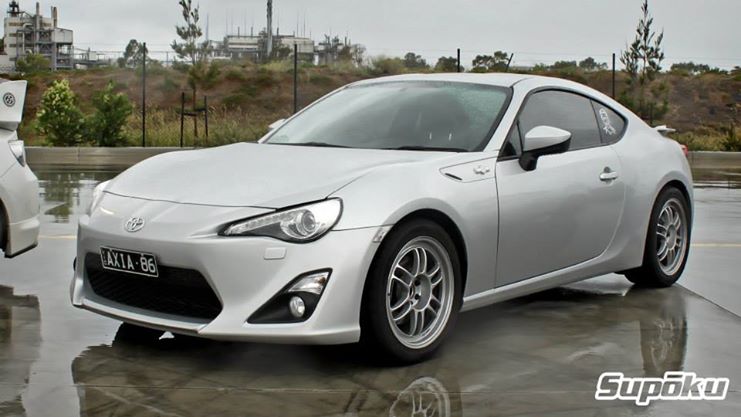

What about a 17x7.5 wheel with a +40mm offset riding on 205/45-17 Max Performance level tires? Personally I feel it works the best for bringing out the dynamics of the chassis, plus with the better gearing and lower CG the car just does everything better. After I wear the stock tires down (almost done) I'm going back to 205/45-17 tires on my 17x7.5 +40mm wheels... precision and agility is just beyond that of any other wheel/tire size configuration I've tried, not to mention it has the best ride quality.
17x7.5 +40mm Enkei Fujin's with 205/45-17 Kumho Ecsta Sport LE's - the most agile and balanced setup that I've run so far on the car (because lowest unsprung weight and matching a good tire's tread width to wheel width is EVERYTHING for agility in handling and ride quality:)
https://vracer111.smugmug.com/Cars/S.../5315-3-X3.jpg

Vracer111 09-28-2015 11:18 PM
Originally Posted by perryair (Post 2404406)
does the tire stretch of 205 and 17x7.5 affect handling at all?
205 tires are designed to fit on 7.5 wheels...not really a stretch. It's the perfect fitment for the size actually, a good 205 tire will have a 7.5" to 7.7" tread width which matches well with the 7.5" rim width. When you match the tread width to the rim width you are at the optimum match for handling agility. Yes, it does affect handling - it's noticeably better and more precise.
The main thing is the CG drop you get with the 205/45-17 tires really adds to the stability of the car while the smaller diameter and lower unsprung mass of the tires really add to acceleration, and precision steering and overall agility of the car - it responds quicker than before yet with more balance and stability. More grip too; because tire compound, not tire width, is what mostly determines grip levels.
Tire width will fine tune grip, but it also adds weight and looses some responsiveness - leading to an overall worse ride. If you are looking to make the car as light on it's feet and nimble as possible while still feeling planted and stable, you can't beat going to a 205/45-17 sized tire with a 7.5 width wheel. I also would not push the offset much past +40 if you are interested in agility... when you start getting to the +35 side of things you are trading responsiveness for stability with the wider track. As good as the 17x8 +36mm offset wheels I had used on track were, the car is just plain slower in responsiveness/precision with them and 215/45-17 Extreme performance tires (Kumho XS) than it is on 17x7.5 +40mm wheels with 205/45-17 Maximum performance tires.
It's all in what you want from the car, 17x8 wheels with 215/45-17 tires are excellent overall. In comparison though, 17x7.5 with 205/45-17 wheels will boost the reflexes, acceleration, and feeling of stability. At least that is my observation running them on the stock suspension. When you lower the unsprung mass...the car just rides much better and responds quicker.
