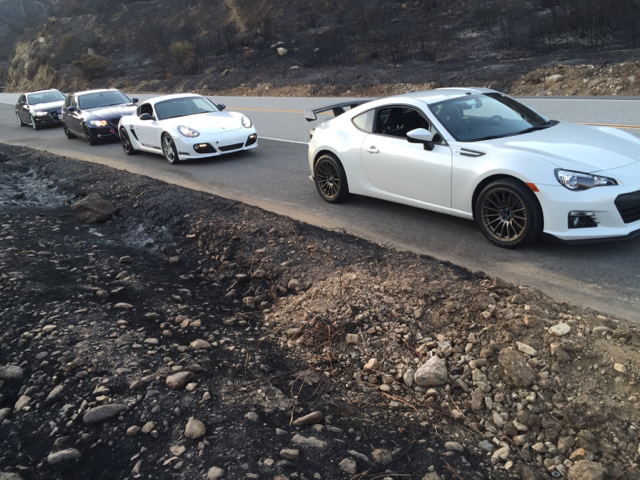

Attachment 120464
with oem suspension is fine, if u lowerd, 245/40 tires is better, right now im running 255 and it is a little wider
