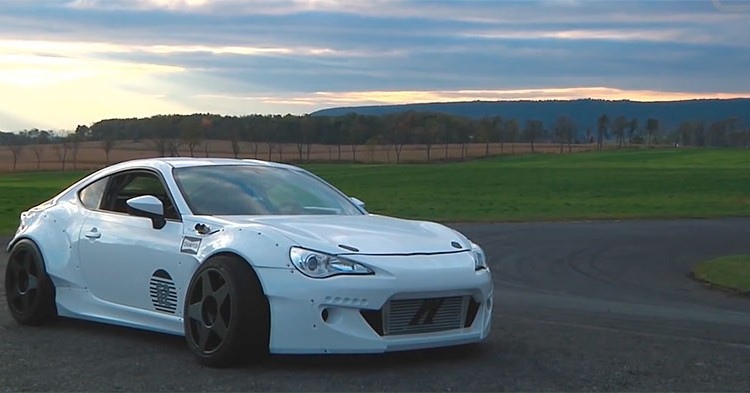

I was wondering about spacers on drift cars the other day to. If you look at Ryan T's white personal fr-s, it looks like he's running some mad spacers, especially up front. Attachment 120287

May i say that it looks ugly? Like if some king-kong stomped on car and due pressure car was flattened into road with wheels broken off. Though then again most hell-a-flush cars also look ugly in my eyes, and as usually it was done "for looks", i could never understand - why, as result is .. arguable.

Lol I can kind of see that king Kong thing now.

Ryan does not run spacers, he runs extended arms. It allows him to steer better and maintain vehicle control with full lock to lock motion
