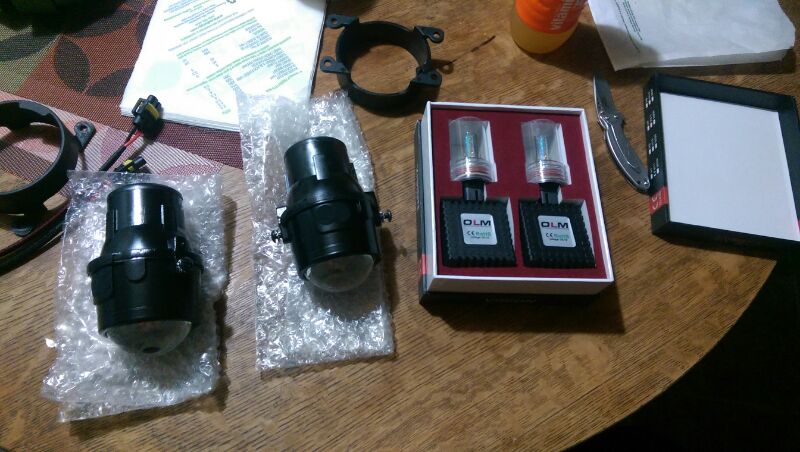

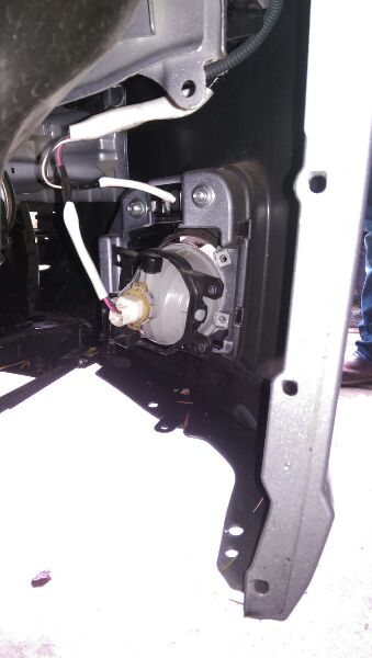

I ordered them with an attached compact ballast which simply plugged into the back of the bulb which inserts into the glass housings. Being as the car came with factory foglights everything was plug & play so after removing a few fender lining clips, and a bolt or two I simply swapped out the stock housing and halogen bulb with the new glass housing and HID bulb.Attachment 119334

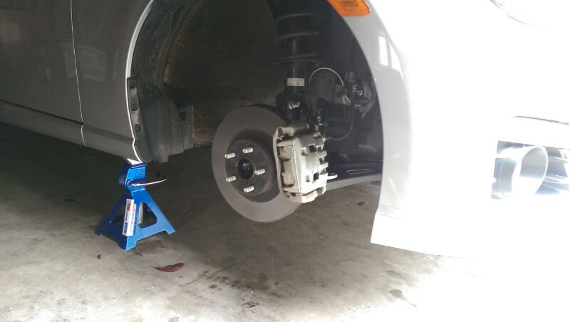

Note: On Subispeed's tutorial for install on a WRX they say you can do the swap by simply turning your wheel to make room but I found it would be easier to simply just jack the car up and take the wheel off. Attachment 119333 Being as this is my first post and review if anybody has any comments or suggestions for future posts that be greatly appreciated, thanks!

Attachment 119335
Glass projectors and HID's with all in one ballasts

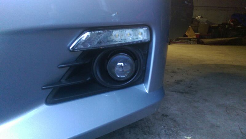

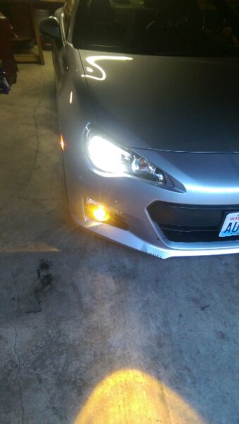

15limited 09-02-2015 11:27 PM
2 Attachment(s)
Pictures don't really do these things justice, neither do my cell phone photography skilz , but they put out some light! Attachment 119393
When they're not on its hard to tell the difference between the factory housing.
Attachment 119394
