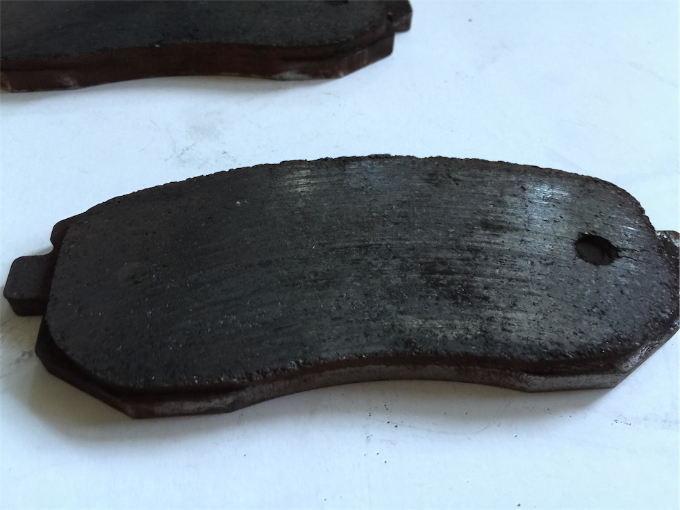

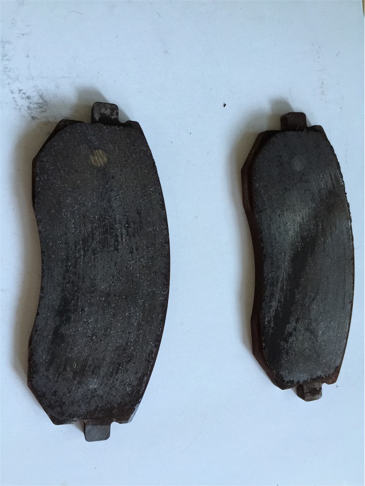

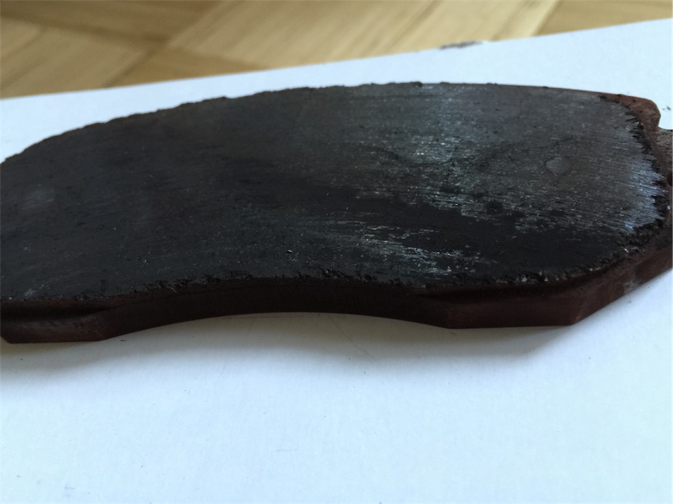

Now I consider myself a novice driver, so thought the pads would last a bit, but checking them today, I saw the fronts were completely worn. The left side was almost to the metal, the pads on the right front had a bit more left. Rears are like new.
Here's a few pics:
Attachment 118541
Attachment 118543
Attachment 118544
Attachment 118542
What could I do to make them last longer? Ducting? Or just run XP10's or even XP12's? Is this even normal wear?
To clarify 100% of the laps are with pedaldance and tires are OEM Primacy HP's.
@CSG Mike / @CSG David any recomendations? Will be getting new sets from you guys hopefully (e-mailed you about local pickup), but which ones...
Thanks for any help!

You are glazing those pads. YOU absolutely need to upgrade!
If you only use these for track duty, I'd rather have you go straight to XP12, to make sure you have enough pad.
Also, make sure you're not using ABS; your video sounds like you are heavily relying on ABS. ABS will heat your brakes up much faster than threshold braking.
