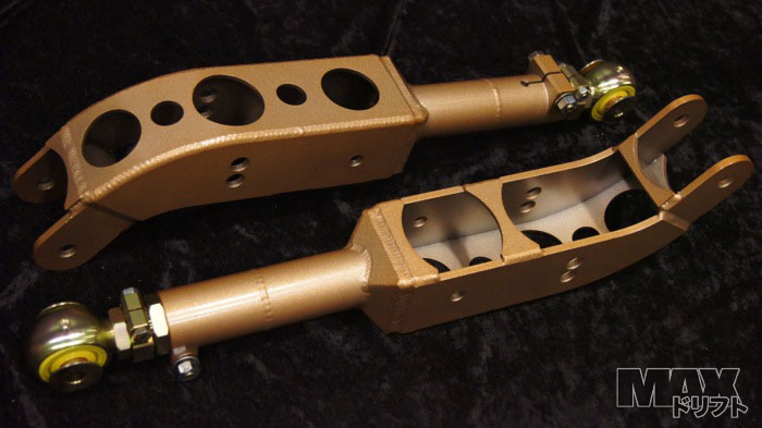

solidONE 08-14-2015 02:10 AM
If you want a LCA that can take some abuse.
http://www.partsshopmax.com/e107_fil...6_dsc05901.jpg
These things are super beefy, but they're also several times the weight of the stock piece they replace. They will also lower the rear at least 25mm without any other changes. I'm assuming this is what you're into.
