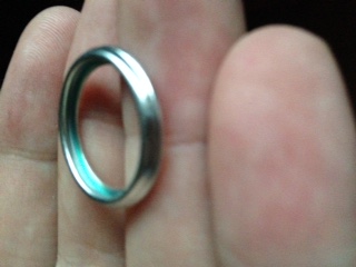

I ended up reusing the gaskets for the transmission as they still looked new and undamaged, and the gaskets I got from Toyota only matched up for the LSD. The transmission gaskets look solid and don't crush when tightened.
So this is the gasket you can use for the drain and fill plugs for the LSD, these actually crush when tightened:
Attachment 117289
Attachment 117290
