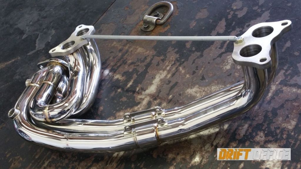

Some months back while we were on the topic of the ACE headers with our counterparts in Taiwan, I was asked if we would be interested in doing remote tunes (non E-Tunes) on UEL headers that were specifically, of a certain sort. As they started to describe these headers with their 4-1 collector design, honed runners and surfaced flanges, I had the suspicion that they were actually describing the TOMEI setup that we've been pumping out as of late. A quick picture also confirmed that it was indeed a UEL offering, very close in design with the above-mentioned. That said, there was really very little in the way of discernible differences that we saw, sans the “Tomei” stamp on the flange surface as well as the tacked on name plate that we were accustomed to seeing.
Attachment 115772
Attachment 115773
Attachment 115774
Attachment 115775
Attachment 115776
As you can see from the pictures, the quality of construction is top notch. Note that these aren't KNOCK-OFFs as some have described them to be. They're “white boxed” versions of the TOMEI offering. They are in fact, manufactured from the very same machinery used to make the TOMEI headers - there's no variation in material quality, construction but there's a ever so SLIGHT change in design (runner angles) to elude from infringing on IP or exclusivity I suppose. All this comes with a reduction in cost while still being able to attain in this case, the best out of the box results thus far!

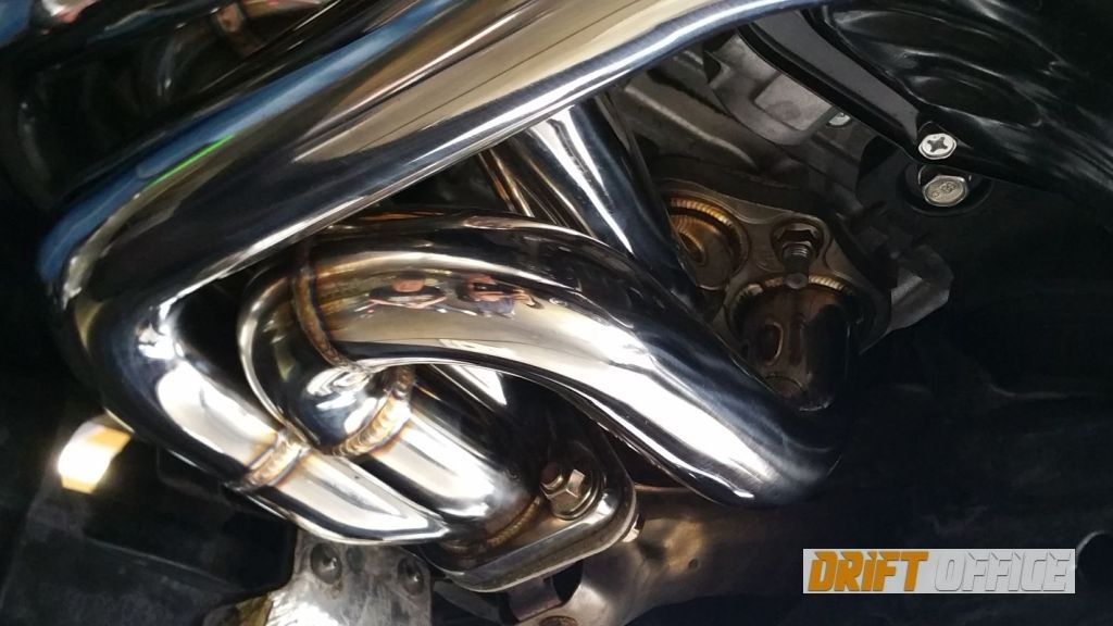

As far as installation goes, there's really nothing to talk about. It was fitted without a sweat, process was as expected and flawless.

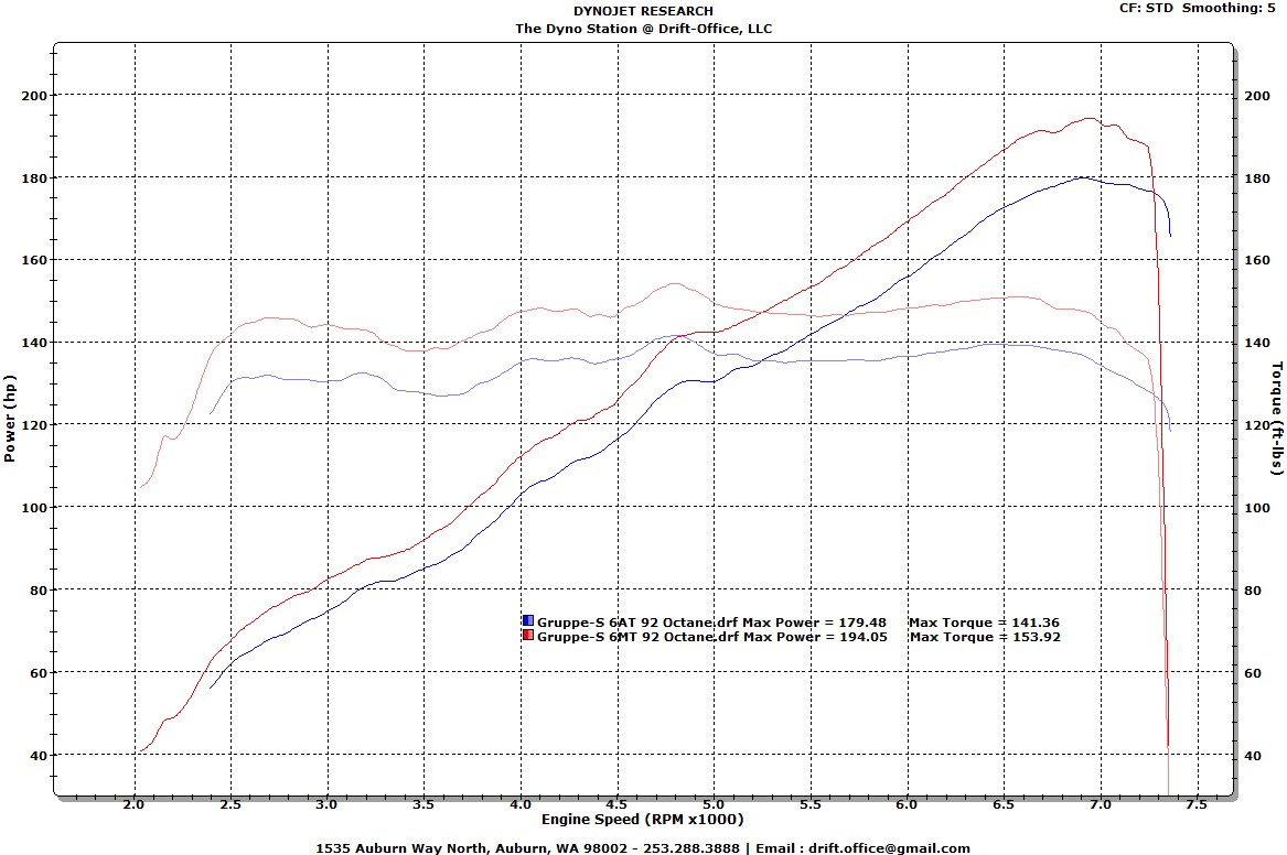

In comparison, I've elected to post up the 6AT 92 Octane results of the Gruppe-S UEL as well, also with an AVO dry panel filter and with a stock exhaust. (I've since done an AT and another MT.) Results are pretty much in line with what we'd expect from a properly tuned setup. So is the Gruppe-S UEL better than the Tomei UEL? Hardly, and that's to be expected. But is it just as good? Every bit so.

I apologize in advance for being a noob. But why is there such a dramatic difference between the MT and AT in the final dyno chart? Is the AT really that poor at transferring power to the wheels?
Drift-Office 07-29-2015 02:27 AM
Originally Posted by icybrzzz (Post 2338352)
Very interested to see videos of this header in action!
Oh hell. Totally forgot to upload that! Check back in 24 hours!
Basic drivetrain loss. Gear ratios are different, hence different results. It is not specific to the FRS, or GT86. It's commonplace in all MT vs AT variants.
