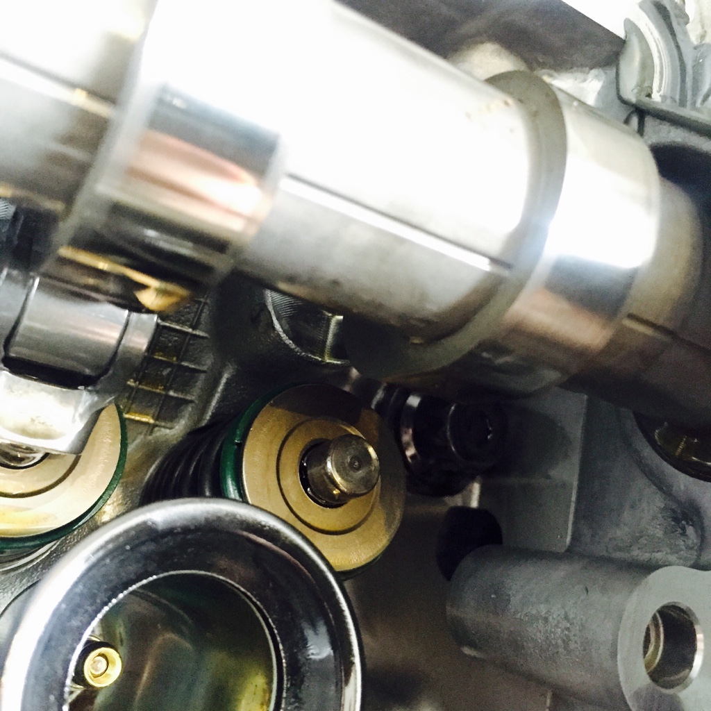

It was boosted for 10k miles, all happened after I took the kit off. oil pressure light came on once while driving, than ended up shooting the rocker arm out.
I already ripped the motor out, and the head it's got damage
Attachment 113843
Attachment 113844

head should be fine I would replace the Cam.... @Element Tuning had this problem
They have a fix for it
http://www.ft86club.com/forums/showthread.php?t=73858
Edit***
You are the 4th person I can remember this happening too... ON the Passenger side head....

Sounds like and excuse for a built motor lol. Element Tuning has a fix for this. They did my built long block.
