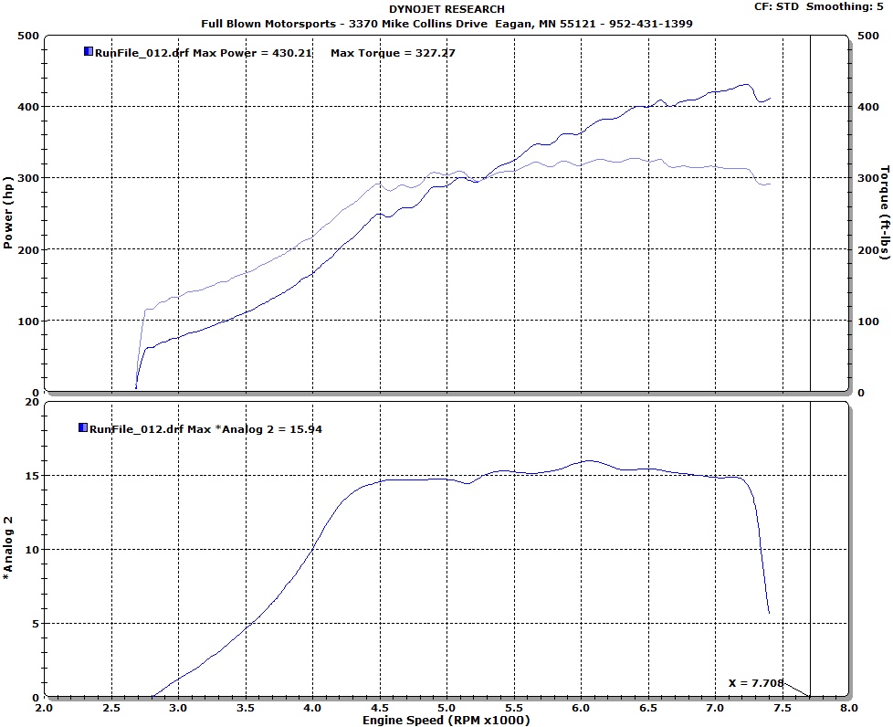

On Crappy 91 Octane Canadian gas we managed to squeeze 430whp/327wtq out of her at 16PSI.
Attachment 113328

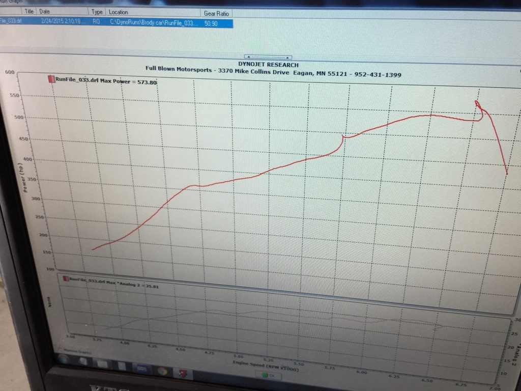

So when that wasn't good enough, we upgraded the fuel system to a return fuel system to handle the boost, at 25 psi we had 573whp and no tq numbers due to spinning on the dyno with 2 guys in the trunk, still lots of room to play with the upgraded fuel system. A video of the pull can be seen here.
[ame]http://youtu.be/mcUsV7fE4Bs[/ame]
Attachment 113331

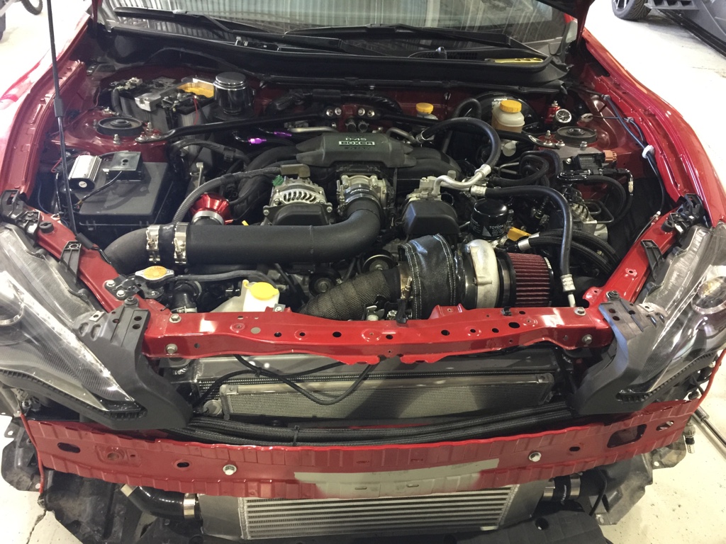

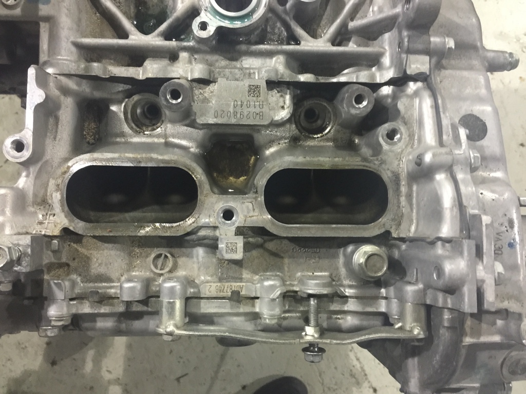

Engine work pics;
Attachment 113351
Attachment 113352
Attachment 113354
Attachment 113355
Attachment 113356
Turbo and what not lol;
Attachment 113357
Attachment 113358
Attachment 113359
Attachment 113360
Attachment 113361

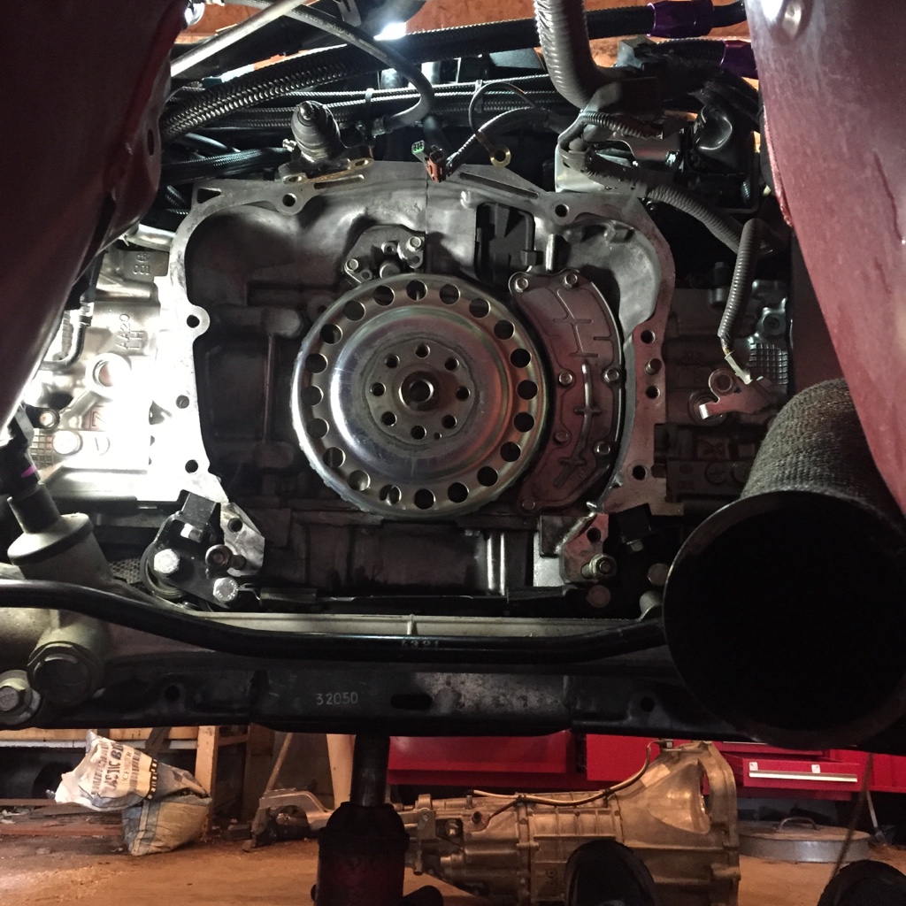

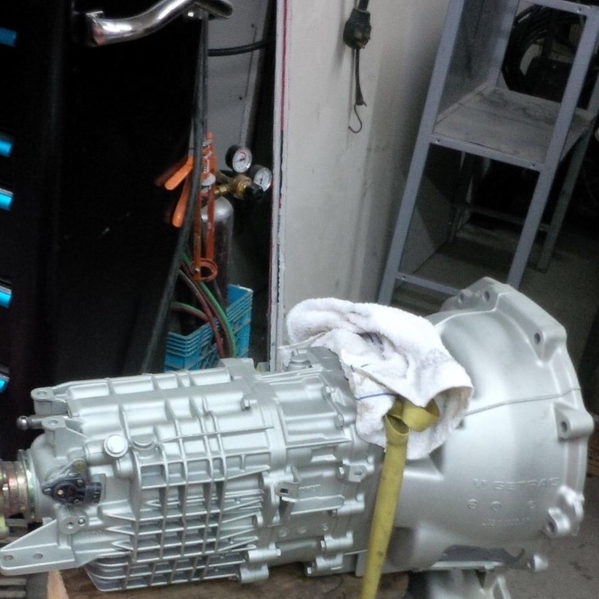

After 3 weeks of driving the car post FI, with no launching and not very many 3rd/4th gear pulls the oem transmission let go, so decided to go with a reliable v160 swap.
Attachment 113362
Attachment 113363
Attachment 113364
