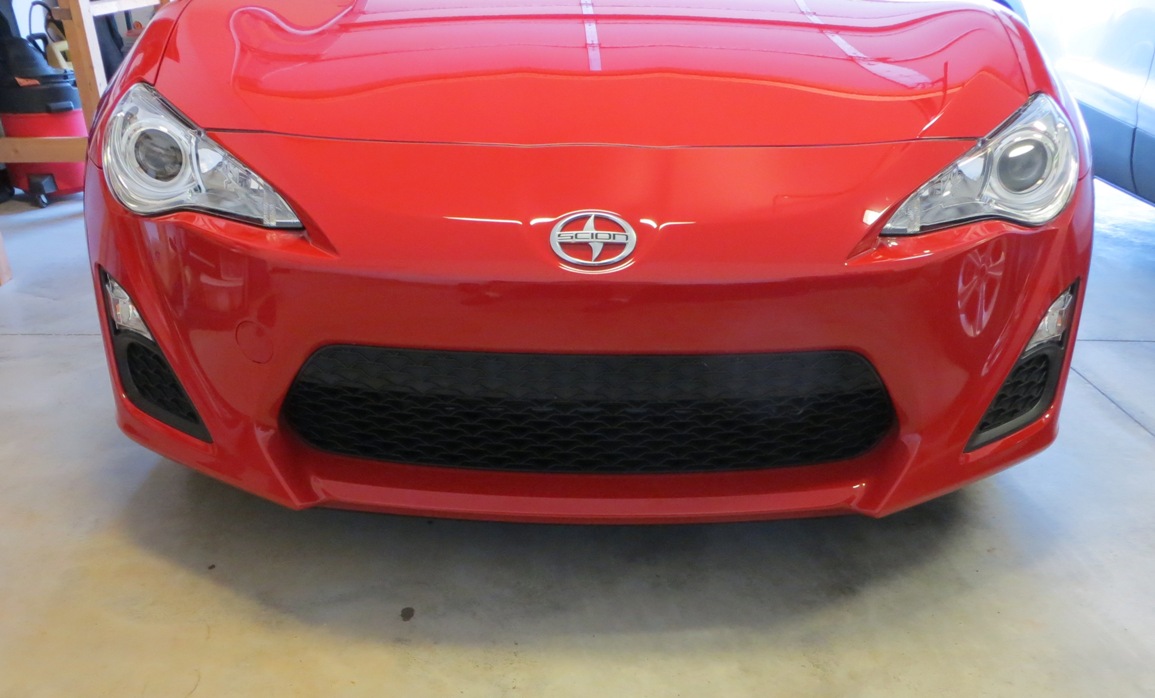

Back from vacation and FINALLY got a chance to install the skid plates. Installation took longer than I expected. I didn't run into any problems but lots of those plastic fasteners to take off, carefully. It's also a stretch putting on the end washers and nuts on the side pieces.
Thanks to MotoIQ for the illustrated installation instructions. http://www.motoiq.com/MagazineArticl...kidplates.aspx NO instructions came with the plates.
Pros: Made from HDPE. Installation is fairly easy. Comes with stainless steel screws and nylock nuts. Unlike a lip spoiler, the plates are barely visible from above.

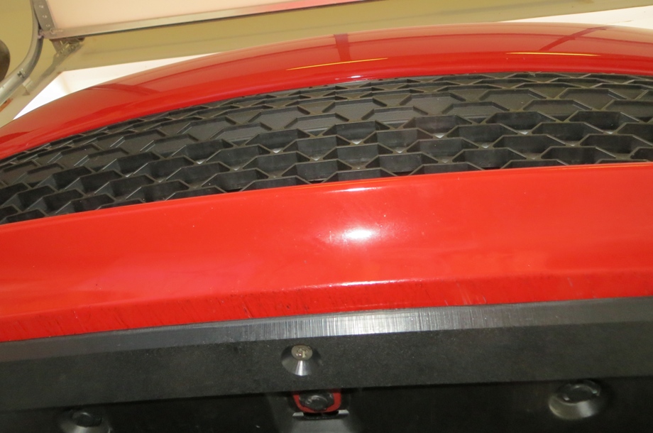

Cons: IMO, the front plate for the FRS could have been made wider (see my pics). The front uses 4 of the existing screw holes that are bigger than the provided bolts. Even with the plate pushed forward there's still about ~1/2" of flat bumper left in front of the plate. Most of my damage has been to the first 1/2" of the bottom of the front bumper.
The sides of the bumper curve upward fairly quickly but not the front.
I believe this has been discussed before and hopefully the front plate will get hit before the bumper. I've also been a lot more careful of late.
The plates with shipping are a bit pricey. But what after market item isn't.
My driveway is steep so I was able to install the plates without jacking the car up.

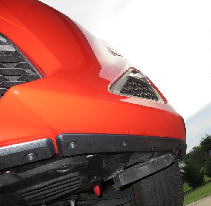

The side plates fit perfectly. The bumper curves up sharply on the sides.

I pushed the plate towards the front as far as it would go and tightened it down. There's still ~1/2" of flat bumper left.

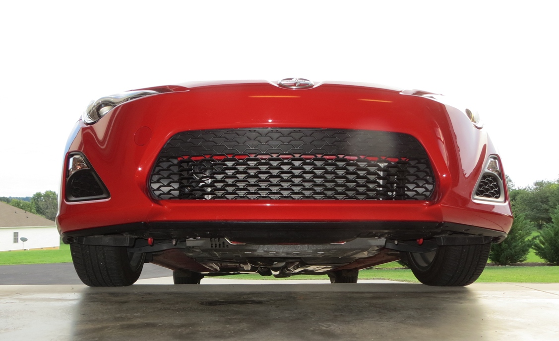

Plates not visible from front.

To answer your question about the width of the center skid plate, we originally made prototypes that were wider as you are suggesting, but be learned that while the bumper appears flat, there is actually a very subtle upturn, about 1/2" from the leading edge of the bumper. On my car, that created a very small (like 1/8 to 3/16") gap between the bumper and the top surface of the plate. In testing, small rocks and dirt were getting caught in that small space, and damaging the paint as it got held there. We shortened the plate to the current shape, and that solved the problem.

BTW, i know exactly what you are talking about, and the first prototype plates that i made for my car were wider, in an attempt to cover the area you are talking about. but if you look REALLY close, you can see that the bumper has a very slight kick up, (right were the current plate stops) and that created a gap that trapped rocks and debris between the plate and the bumper cover, so we shortened it a little to solve that issue.
Even still, since there is drilling needed to mount the plates, there is nothing stopping you from simply moving them to wherever you want, drilling the holes and bolting it up!
