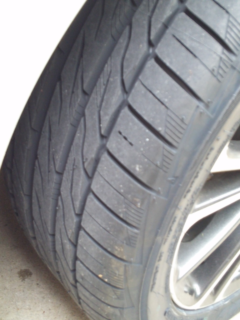

Well, I recently went with nitto motive tires 225 all around. Thinking I would love them, I wasn't to satisfied. They somewhat hydroplane, shoot rocks and chips upward. Although the grip is somewhat good. I think I should have gone with Michelin pilot sport..

Astroboy 05-30-2015 06:30 PM
225 vs 215 on oem wheels?
Astroboy 05-30-2015 07:09 PM
