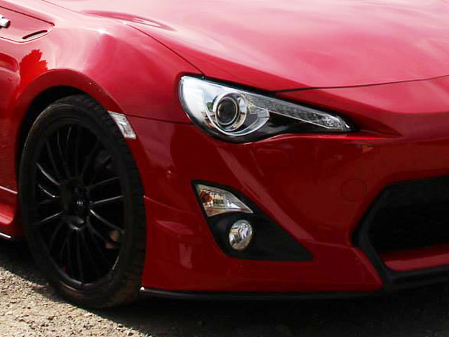

Hot Toys 06-15-2015 10:34 AM
racingbees FRS foglight
2 Attachment(s)
I installed one for my friend's FRS and it seem to work for me NP, but I had to change the pin around to make it work. here is the picture of the wiring. also I added washer at the back of the lamp to make it fitting better.[ATTACH]112Attachment 112436435[/ATTACH]
