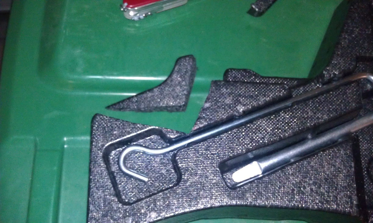

The tool holders won't fit back into place without a little cutting. You can probably get away with cutting a smaller portion out from the bottom, but I cut it so that I could take the bar off and back on without having to take the styrofoam pieces out again. Remember to pop the clips back in so they don't fly around when you're driving around.

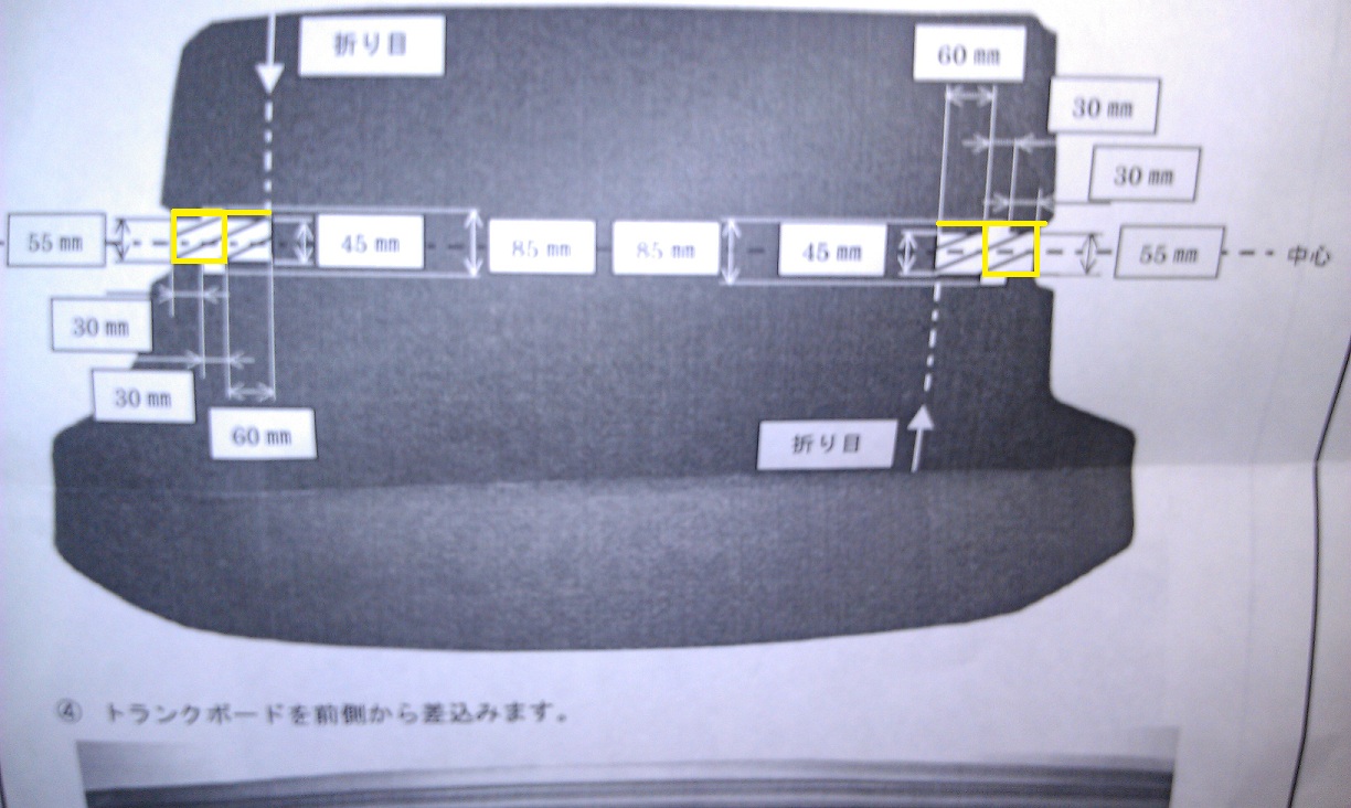

The carpet cover also needs a trim to get it back in place. The directions given calls for cutting out pretty big chunks out, but I found you only had to cut along the yellow lines. It does require a bit of shuffling around to get it back in, but looks better than how the directions would have you cut it imo.

There isn't much difference between the way I cut the cover and the way they want you to cut it. If you cut it their way, it'll be a little easier to take the carpet in and out, but you'll be able to see a bit of the spare wheel well and some of the styrofoam. Either way, once the carpet it out, you have full access to all the tools and you can take the spare out without having to touch the bar. I just ran out and tested this :)

Looks great! Unlike you, I did not have to trim the tool trays at all, just the carpet. I managed to squeeze the tool holders back into place without any issues :thumbsup:
