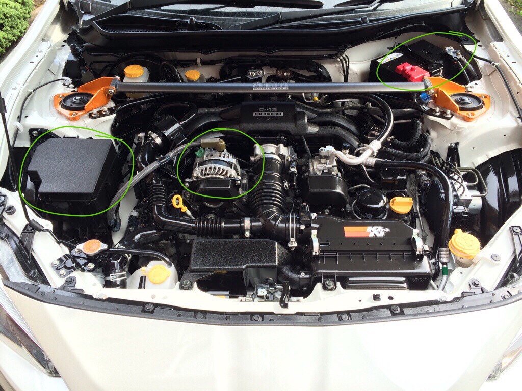

Do you guys have a picture of how you covered some of the electrical components before cleaning?
Foulsmell 05-24-2015 12:02 PM
I don't but it's straight forward. Just use some aluminium cooking foil to make a cover for the parts circled in the pic. Then when you hose down from a vertical position they won't get wet. Just imagine like an umbrella. Attachment 110465
