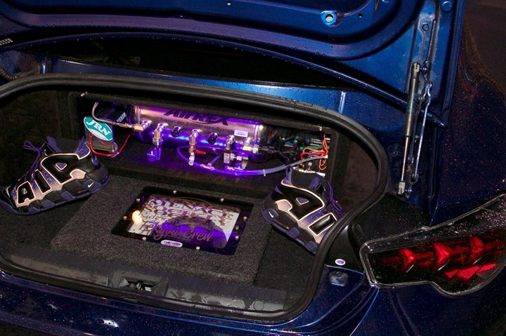

xxscaxx 05-05-2015 01:31 PM
If you want the most optimal space the above is the way to go. That is a really small tank though.
I opted to raise the floor about 2 inches. It does take away trunk space obviously but you can still use the trunk and put the seats down. If you mount it anywhere above you will be limited to what you can put in the trunk.

xxscaxx 05-05-2015 10:01 PM
Originally Posted by GH05T (Post 2238596)
What size and model is your tank?
its an accuair 3 gallon tank. Sorry should have mentioned that lol

Thanks! Thats with the exo mounts right?
xxscaxx 05-06-2015 01:38 PM
yes sir. I had to modify the bracket a bit to get the airlift manifold to fit but all that it requires is drilling two new holes which is easy.
Depending on the exhaust choice if you go aftermarket you can actually mount a tank right in the stock location of where the stock muffler currently sits - thats another option with the tank mount. Only downside is if you wanted to swap an exhaust or back to stock you can't unless you move the tank.
