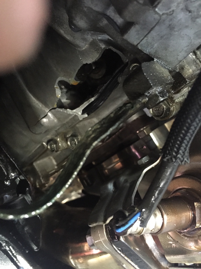

Recently blew the Fa20, just over 36k miles.. been debating on what to do with the car and came to conclusion I'll be doing a 1J with a R154 tranny, still haven't purchased the motor or anything for it just because I'd like to shop around and not jump into. more likely I'll be piecing it slowly. Gonna start this awesome project in the next week or two! The motor as it sits currently

continuecrushing 04-21-2015 07:09 PM
that hole doesnt belong haha...
what happened?
PolishFrs13 04-21-2015 07:41 PM
haha it works fine!
well I'm not sure yet.. haven't taken a closer look to it. But I was turbo'd for 10k went back to stock and about tree weeks into being stock this happened cruising on the highway

spitfire481 04-23-2015 01:16 PM
looks like you shot a rocker out. its a problem with stock valve springs and high rpm/power. usually doesn't cause any valve/internal damage though
