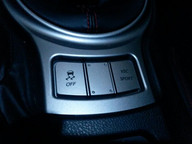

Bramick 04-13-2015 08:27 AM
How about here.
Attachment 106971

technoid 04-13-2015 12:20 PM
No go on the Silver plate, as I have a Snow / Sport selector Switch there.
