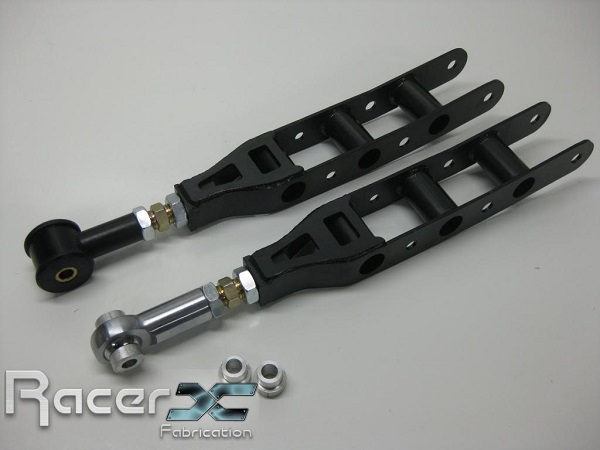

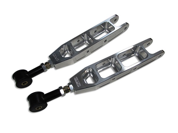

Captain Snooze 04-08-2015 05:26 PM
2 Attachment(s)
Originally Posted by Zzzquil (Post 2204664)
@Captain Snooze - Are you running any LCA's?
I have first release RacerXFabrication lca but they no longer make them in that style. They have changed from welded plate
Attachment 106582
to machined aluminium.
Attachment 106583
Another consideration is whether you want urethane bushes or spherical ends.
