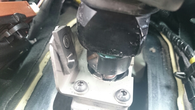

I was having trouble getting into reverse again... Open up the console and see this. =(Attachment 106482
aznatama 04-08-2015 10:20 AM
Follow up:
So the screw holding on the two pieces on the left basically fell out. For better or worse, the screw made its way into the gap for the ball joint, causing a VERY dangerous condition called "getting stuck in gear."
This reminds me of the 2 times I literally got stuck in 2nd gear merging onto a freeway. Good thing both times it was in little to no traffic. At first I though my gearbox had gone to shit, but now I realize that it was this little bolt's fault.
I cleaned up everything, checked the threads, used some loctite, and put is all back together. However, I now have problems getting into reverse, again. The "I can't get into reverse" problem has appeared. This is really frustrating... to rehash the problem I had earlier...
the shifter stop plate is adjusted as far right as it can go, allowing for smooth and proper 1st geat engagement. if I move it to the left, then it won't go into 1st properly, but rather, it'll seemingly hit the "shelf" between reverse and first, so I have to install the plate as far right as possible. However, when the lockout is lifted and moved to the left to get into reverse, it doesn't seem to move far enough to the left. It'll hit the "shelf" and refuse to go into reverse. I have to muscle the shifter further to the left, basically flexing the entire shift carriage to get it to move over enough to get it into reverse. Feels like the "bump" on the shifter itself is too small. Moving the lockout plate to the left and increasing the size of the "bump" would solve this problem.
Any suggestions to get this thing to work correctly? @TWMPerformance

Thanks for bringing this to our attention. I think your best bet is to completely take the shifter out and re-install it following our instructions as closely as possible. If you still encounter the same issue, please let us know. We want to ensure that this situation gets fixed so you can be plowing through those gears again!

Cleaned and reinstalled it already. The only problem is the reverse engagement. Shifting the lockout plate to the left may solve this, but then I'm worried about proper first gear engagement.

It only takes a small amount of adjustment to perfect the 1st/reverse gear engagement. Slide it left very slightly and see if the problem persists. Keep us posted.
