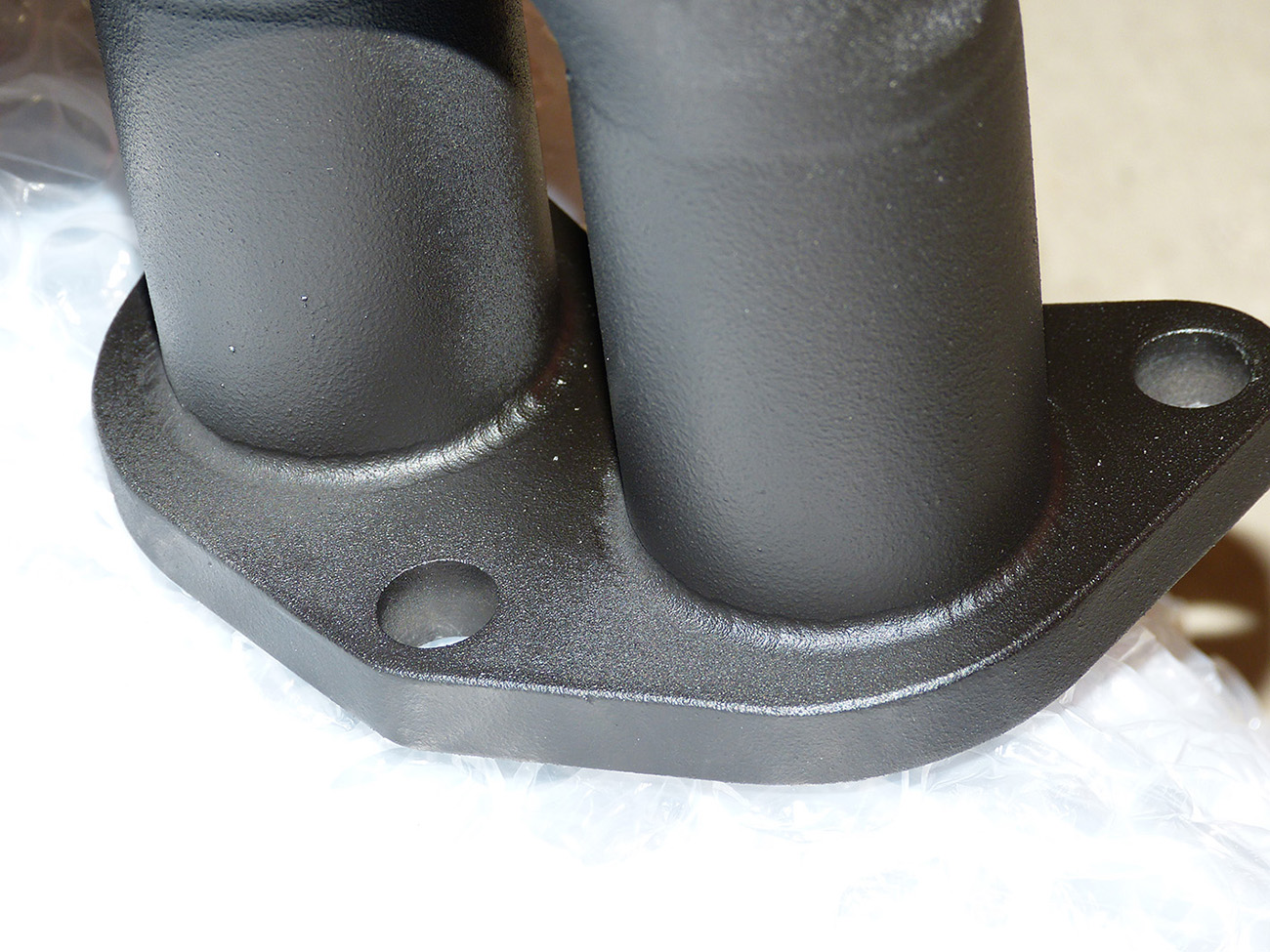

Highly recommend, header so cool you can touch it after the drive. Amazing. ;)
Attachment 104916
