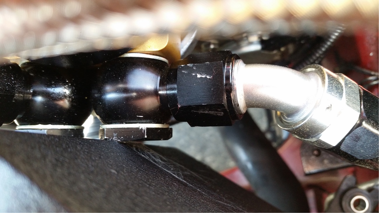

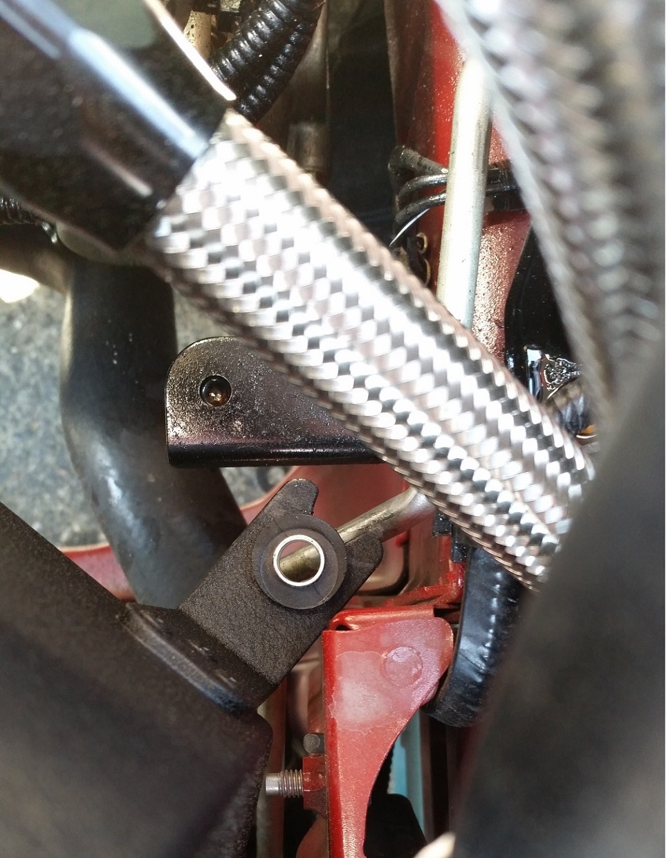

the bottom mounting point is not anywhere near the bolt hole and the oil line connectors are in ccontact with the boxAttachment 104756
Attachment 104757
Attachment 104758
Attachment 104759
Takumi788 03-17-2015 03:00 PM
Can you rotate the sandwich plate counter-clockwise?
Sorta like this

Yeah what Takumi said, it looks as if you have a really good shot of fitting if you rotate the sandwich plate towards the Oil Cap, and then rotate the fitting for the banjo bolt nearest the cap up instead of sideways.
Let us know if that works, or shoot us some more pics to see how close it is for reference, and we'll keep helping ya!

As noted by GS and Takumi, rotating the sandwich plate should provide a bit more clearance. Let us know if this provides the needed space to use these two components together!
