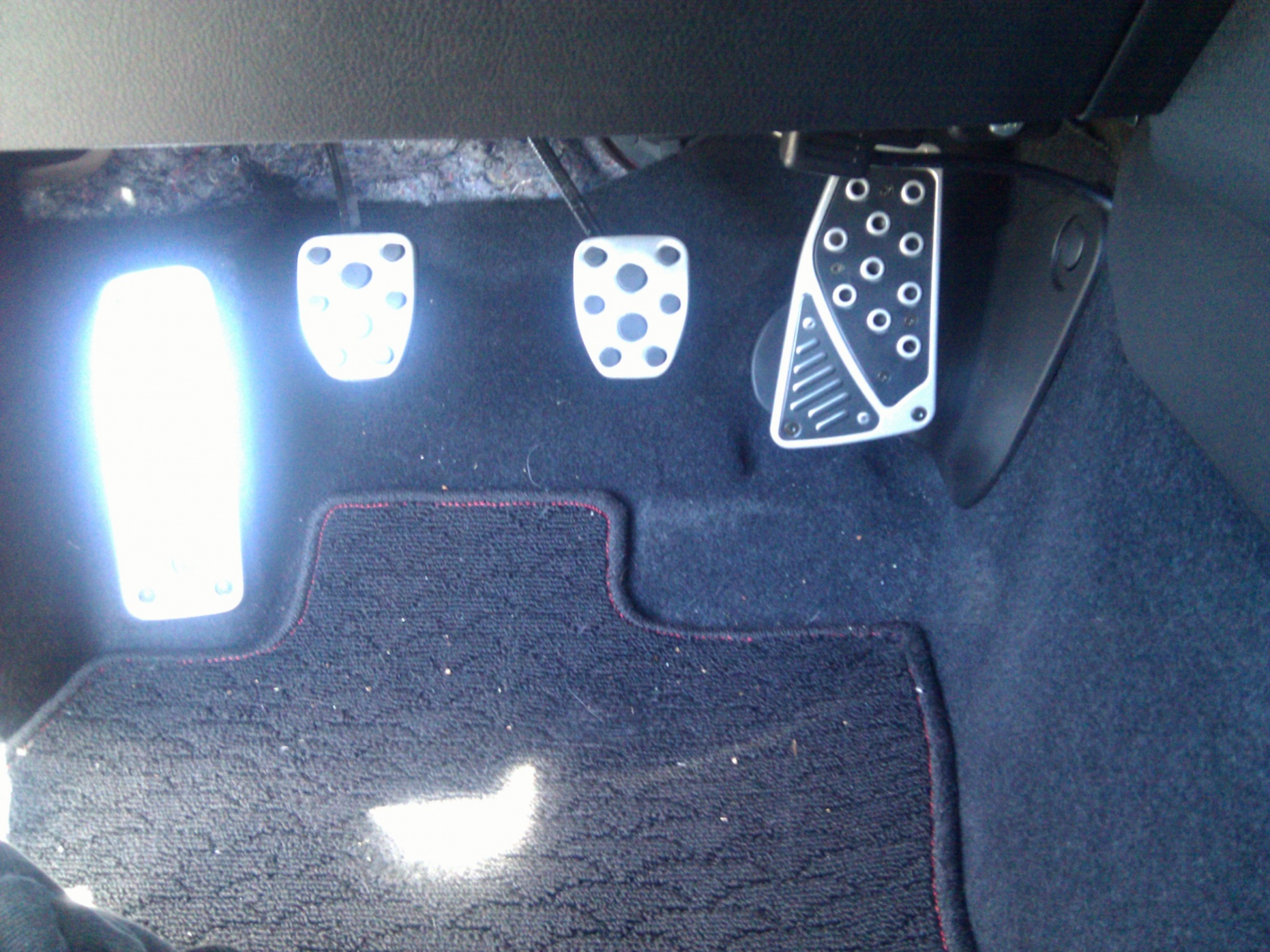

pkny 06-10-2012 04:01 PM
2 Attachment(s)
Although I can heel & toe using stock pedals, I found it is much more comfortable using this:
Attachment 8376
Attachment 8374
I have a whole set sitting around in the house for years. After driving the FR-S for a week, I thought why not install the gas pedal and give it a try.
I've been driving using this for three days. I love it very much. Heel & toe is never easier.
