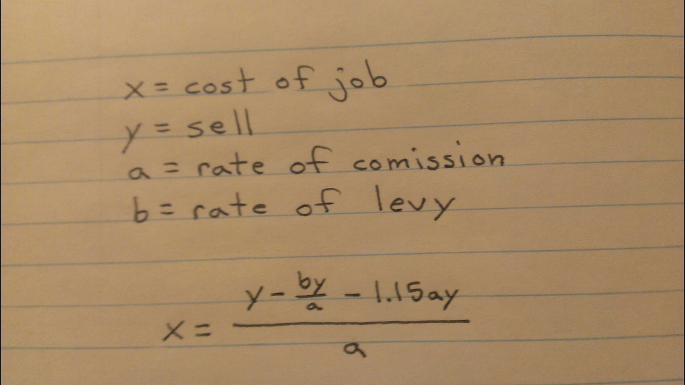

Attachment 102415
Once you fill in the rates and simplify just solve for y. Use that value of y (expressed as a value of x) to calculate the amount of the levy (expressed as a value of x) and the value of z (expressed as a value of x). Then use that value of z to calculate the amount of commission (again expressed as a value of x). It's not mathematically correct (unless I'm wrong in which case I'm right) but it should be close enough for reality. If you want a mathematically rigorous solution then I'm not gonna be much help.

Amaya, I think it would be more helpful to solve for y (the sell), as it makes calculating everything else easier. Besides, X is a known quantity.

The problem is that the commission/levy will continually increase but because the rate at which they increase is getting less and less and is a very small value this is probably accurate enough. A more accurate answer would be slightly higher than what I came up with.
Edit: now that I've had a little sleep I realize that I'm wrong about it increasing and it just requires straight forward algebra to solve
