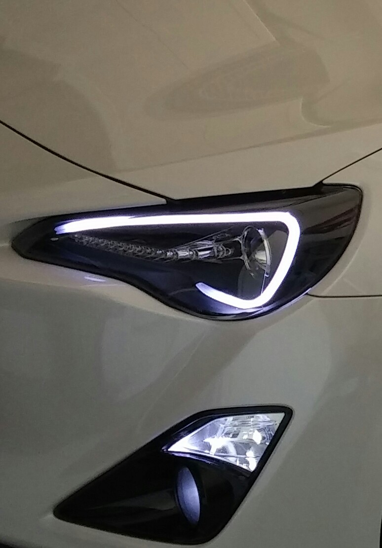

I'll upload a photo later today to show you how they look on my car :)
FRSNewb 05-29-2015 07:36 PM
https://scontent-ord1-1.xx.fbcdn.net...99&oe=55EFCD54
