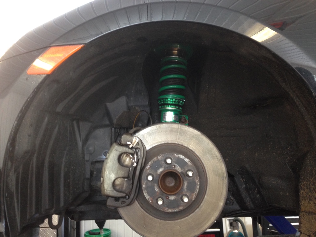

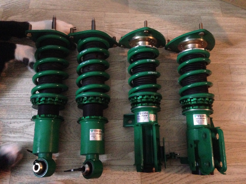

My first impression out of the box: the coilovers seems very solid, well painted and protected against rust, seem to be a very good quality, click adjustment gives a really good feeling, the top plate on pillowball are great and you can easily adjust the camber in front, adjusting the vehicle height is very easy with the Tein key and without modifying the preload.. seriously the quality is insane I love them.

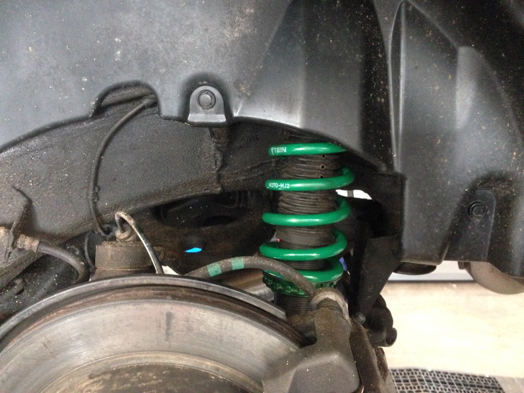

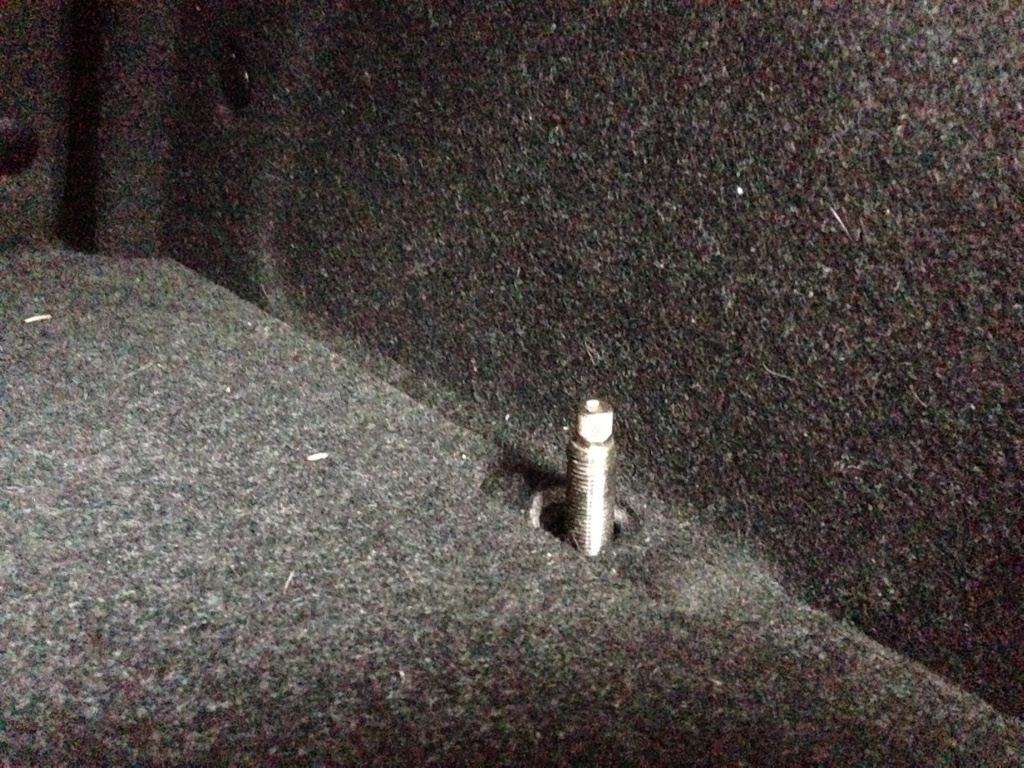

Installation: very easy and mainly if you have anti-seize everywhere. The place to fix the brake lines and ABS lines are positioned as the original ones, so no problem there ... In a few hours it's done. All fit #1 without any adaptation or modification except for the 2 holes in the trunk to provide an access on the rear damper adjustments. The instructions include 8 pages in Japanese and 6 in English ...+1 for the fit.

Adjustment: very easy with the tools provided in the kit. I dropped the car an inch and I have not touched the preload to begin.

Important Note: adjustments to the dampers can go to 28 clicks but after the 16th they are only useless click (dead clicks) and it is not advisable to drive beyond that, as this could potentially damage the damper if you hit a deep pot hole or a aggressive bump... I asked Tein directly to be sure about this...
