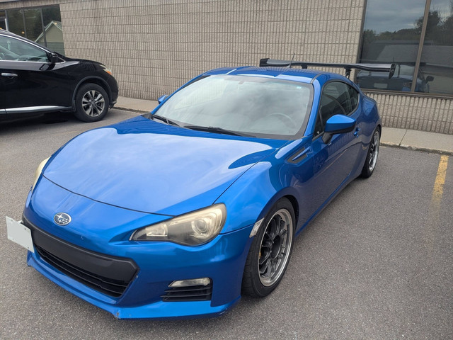

I've changed the format a bit. I'll update this first post with the current state of my car and subsequent posts. This is how my car sits currently:
https://i.ibb.co/tpdM9dJg/brz-current.jpg
Modifications:
FA24 swapped
RCE SS1 Coilovers (f/r rates 6k/6k)
SPC RLCAs
No name adjustable swaybar end links
No name adjustable rear toe links
CSG Brembo BM4 front BBK with CP pads at all 4 corners and Castrol SRF brake fluid.
Stoptech Stainless steel rear brake lines
Konig Hypergram 17x9 +40 with Advan AD09s
APR GTC300 GT Wing
Status: Car is running, but has gremlins.
Notes: Final ride height is now set at 1.4 inch lower than stock and my alignment is done. My camber is -3f/-2.2r and 0 toe.
