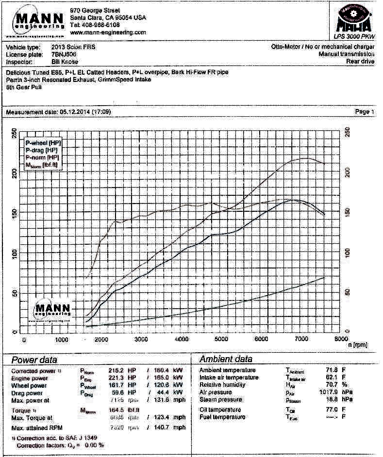

The MaHa dyno runs way longer than any of the other dynos I looked in to. This particular one runs an "Endurance" method, which starts to calibrate itself around 1500rpms and ramps all the way up till max speed. For whatever reason, my car wasn't able to get the dyno to calibrate itself running 5th gear around the required range. The technician floored it, car started to shake, and couldn't move the dyno properly. With that being said, a completely stock FR-S was able to calibrate that same dyno in 5th at 1500rpms. So, the dyno run was dropped to 4th gear, but started to report at a higher range of 2500rpms.
Its not a pleasing feeling knowing your car is having issues and the dyno isn't even anywhere being complete. Didn't end there though. Once the fairly ascending line continued to climb in 4th gear, it suddenly dipped off then climbed back up at 4700rpms. Watching the car on dyno from outside the room, there's a very faint discrepancy you can catch if you pay attention. This is visible later in one of the clips near the bottom; car is strapped in, no outside variables to distract the naked eyes and ears.
1 of the 4 pulls, dip around 4600
Another pull, also showing a dip
For comparison, this is a base Twin with no mods, no dip
Final output, 172WHP with an abnormal dip on all 3 dyno runs. Puzzled now, I took my car back and headed home through a longer route to see if I can replicate the dip. Faced another problem, 4th gear at 4700 rpms is beyond 70mph. Its a bit difficult to maintain that that speed with Bay Area traffic after work-hours. I dont even know if I could catch any dip given all the road noise and feedback, while in traffic.

I'm still skeptical about that sharp dip that only happens to non-Ecutek tunes on Mann's Dyno and not on any other Dyno with any other car. Did you by any chance datalog any of those runs? The only way to get that sharp of a drop is if the Dyno is applying brakes or if the throttle is closing. A datalog would conclusively tell which of the two is happening. And if you still don't feel that dip on the road, I would say that it's not your car that is doing that.
ck-GT86 01-06-2015 07:28 PM
I'm curious to see if my friend's car would produce the same dip, running the 2.06 map. I dont have the OFT anymore, so we could datalog his car and send it your way.
.ck
Shiv@Openflash 01-06-2015 07:38 PM
.ck
I suspect he will see the same weird dip on Mann's Dyno. My suggestion to Dyno the car on any other Dyno that isn't affiliated with any particular tuner. And there are dozens of them in the Bay Area. Preferably a Dynojet since those are intertial Dynos and can't be mucked with to create absurd loading conditions as possible with eddy current loading dynos. I saw the video and I'm not sure what kind of test requires a 45 second long WOT pull. Those kind of pulls are suitable for towing vehicles, not passenger cars. Strange decision.
DeliciousTuning 01-06-2015 09:04 PM
The power loss is also felt on the road, it is in the review.
Vehicle manufacturers perform the same tests and specifically on MAHA dynos.
Cheers,
William Knose
Shiv@Openflash 01-06-2015 09:38 PM
Cheers,
William Knose
William, I drove the car with the owner. Neither he nor I could feel any such hesitation as shown by his first trip to Mann. Something that severe would be about as subtle as a kick in the face. I would be like stabbing the brakes during a pull on the road. In the Dyno video posted you can even see the revs/mph drop for a moment before picking back up. That is not a subtle hesitation. I don't believe the owner ever felt anything like that from my conversations with him or from his previous posts on this forum.
And yes, manufacturers perform steady state pulls and varying ramp up rates to test thermal management, fuel consumption, emissions, etc. But if you are tuning for actual power, it's sensible to test conditions that closely replicate conditions you would see in the real world. I wouldn't exclusively test a passenger car with a 45 second long constant ramp up rate any more than I would a tow truck with a 5 second intertial pull.
The pumping efficiency of any engine is dependent upon not just rotational speed but also rate of rotational speed change. Especially when pushed to either extreme.
Also keep in mind that subjecting a car to a excessicely long dyno pull is unrealistic unless the Dyno cell has a wind tunnel capable of providing airflow speed commensurate with vehicle speed. Most tuning Dyno facilities fall short here. Hence the importance of realistic run durations and inter-run cool down periods. The testing conditions you created in the videos is bizarre. Did you even conduct any tests capturing realistic acceleration rates?
steve99 01-06-2015 10:11 PM
That torque and power hole is bizzare.
not disputing the dyno is measuring it but,
If you look the percentage overall drop and the rate of drop off of that torque hole measured on that MANN dyno and compared it to the standard torque dip .
The standard torque dip is noticable, that one would be like hitting the rev limiter, its a vertical drop and about twice the size of the standard torque dip
If it happened on the road , it would be very obvious
ck-GT86 01-06-2015 10:49 PM
I don't understand the notion behind any intention to forcefully cause a dip by stepping on the brake or altering the dyno, especially for tuners that are local to each other. I doubt either of them are hurting for business; we all go to the same local meets and events. We know each other's names and faces, who drives what, and what each does.
I'm going to accept that there was something wrong with my car, be that tune or not, and it's been tweaked to run better than ever.
.ck

I am not going to debate your evasion of the topic of this thread. The problem exists, you are not looking into it any further and just throwing rocks. Take a step back, step outside the office and test the scenario and replicate it. It happens and can be replicated on the road, especially on a race track.
We are not going to do your homework. If you need to see how long it takes a stock fr-s/brz/86 to perform a 4th or 5th gear pull from 1500-7500 RPM, head to your local airstrip and test it out. You might be really surprised how long it takes...
If you have further MAHA dyno questions I am sure you contact MAHA directly and get your questions answered directly from them.
Cheers,
William Knose
Great Bill. Can you please provide directions on how OTS map users can replicate/induce this issue on the road?
