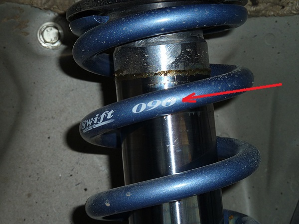

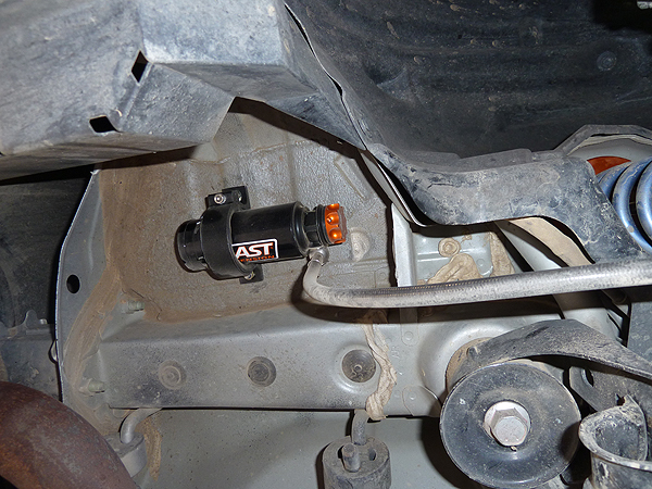

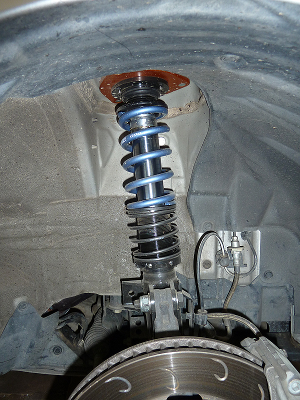

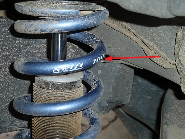

The Drive Home
My phone rings! Yes! It's the suspension shop saying my car is ready to be collected!!! I am then told they have backed off all the damping to max soft. Wtf!!?? I didn't comment but I was filled with trepidation for the drive home. I wasn't going to pull over somewhere to start fiddling with the dampers. I had visions of pogo-ing all over the road. Ummm, nope. I crawed off down the street thinking mmmm...this isn't bad. It felt a little loose but it wasn't as if there was no damping.
There wasn't any float or see-sawing, just a bit more springy than I would have liked. Remember this is on full soft compression and rebound. There were only a couple of times where I thought it was bad but even then it wasn't that bad.
I am very surprised at the ride. That's 9k/10k springs no sways. It is softer than before with the sways. F**k!! I'm thinking I could easily have gone 10k/12k but how was I to know? Anyhoo. At the oft mentioned round-a-bout near home I did 2 laps. I think understeer has increased marginally. I might have to get my rear toe closer to zero. It is on 0.9mm a side atm.OMG! What are they going to be like once I get the dampers set to my liking? What a revelation!! I couldn't try too hard because I had a boot full of coilovers. What is really weird is in a straight line they feel really compliant but then there is so little roll in the bends. I am guessing the roll is about the same as before with the sways.
So, I am finished with the round-a-bout. I am exiting onto a left hand bend. I see the bump which would cause the waggle and upset the composure of the car. My left hand rear wheel goes over the bump and I wondered huh? What happened there? The bump has decreased in size. The was NO waggle. It was totally absent. Wow. I have full inderpendant rear suspension. The car felt so uncorrupted. Ok, I know sways are a compromise and I think as a budget measure they are good value but I didn't appreciate the difference the lack of them could make. Have to remember the Eibach sways are towards the stiffer end of sway bars so they certainly added to the total spring rate on one sided bumps.
I can't feel the road as well as I would like at the moment which is not surprising but for 9k/10k springs I can't get over how soft they are. Tonight's activity will be setting the dampers to the factory default click position and seeing what they are like with some proper damper resistance.
I am thinking that these dampers on softer springs would make for a dangerous vehicle; the car would be so comfortable it would lull you to sleep. On 6k/6k springs it would be such a dream ride. A waste of money but it would be a thing of beauty. *sigh*
Thanks to Michael at RavenTechRacing in Perth for answering all my bride-before-the-wedding-night questions.
I still can't get over those numbers! They are way too comfortable.
