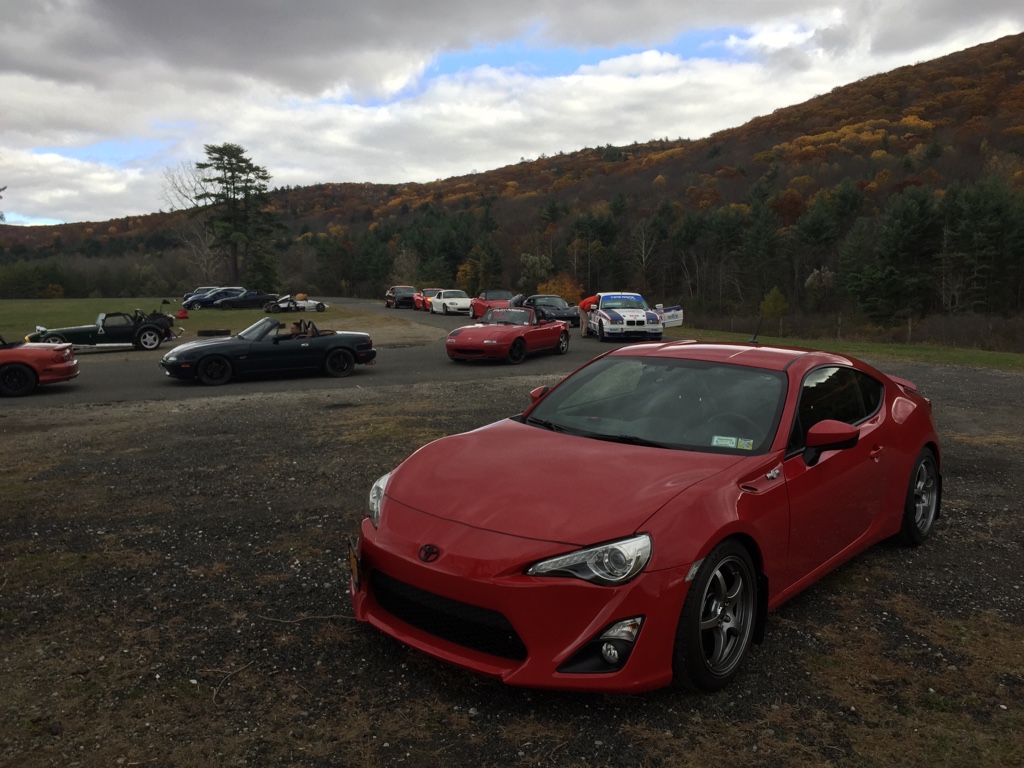

My 2014 FR-S monogram firestorm (JRSC with street/AX/track setup)
That's right, I just wanted a faster and portable GPS, happy with everything else. Not familiar with dampers other than stock, Ohlins and Bilstein B16. I changed springs on Ohlins and had them revalved, to allow a little more rotation, more at low than high speed. You do want camber in front and rear, at least -2.0 and little more negative in front, so you're looking at the right parts. Also consider adjustable endlinks. P3 doesn't work at the same time as MX, as both use obd2. |
After two years and two done up twins, I've been thinking about alternatives i.e. Cobra GT350 or track prepped C5/C6 (never owned American muscle and already owned Boxster and Elise). However, 3 days at Palmer Motorsports Park with NASA last weekend confirmed that my car is now set up so well for my HPDE and AX needs that I'd be foolish to let it go...decided to keep it for at least another year and a new Scion iA (AT) is taking over the daily commute.
