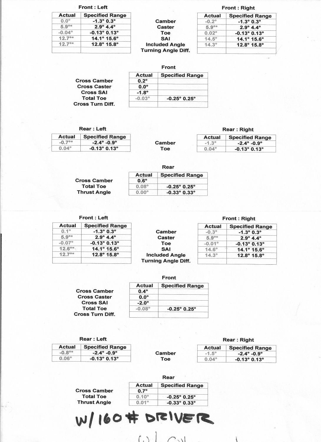

I got my car on the alignment rack today and got the factory set specs. There is a distinct lack of -camber up front and and the "right" amount in the r/r only. I'm guessing that the difference from the l/r is somehow supposed to counter road crown.
I'm surprised how much my weight affects the static alignment specs. The top printout is from the car empty and the bottom with me in it. I'll be using either concentric bolts or plates to get camber adjustment in the fronts, and will equal out the rear. I prefer zero cross/camber and zero cross caster, both front and rear, with zero toe in front and a touch of toe-in in the rear for braking stability.
Input on this subject is appreciated

The actual numbers don't mean anything to me, but after driving a fair bit on the highway tonight, I see what @Ryephile meant about having to work to keep the car in its lane. It's incredibly eager to change direction, but it seems there's a trade-off in highway driving. Would a small change to camber or toe help make it feel a little more centered?
Yeah, the frontal toe out may make it more twitchy at high speeds. Generally this should be 0 for stability and minimal wear.
It blows my mind that they would have 0 or even positive camber in this thing up front with a MacPherson strut design. I'm sure there was some reason but that's hard to justify. So adding negative camber may help cornering stability as well.
BTW taos, are you able to corner weight this thing with you in the driver's seat?

Asterisked Accolade 06-06-2012 11:19 AM
From looking at those pictures, i'm curious why the passenger rear has so much more negative camber than every other wheel.

Looks like there's not much interest in this subject, but I'll keep posting anyway. Part # for the BRZ front strut mount (top) is 20320AA111 which comes up in online part searches as the mount for Impreza and Forester, including WRX. This tells me that camber/caster plates already made will fit the BRZ.
Why am I so interested to know this ? Well.....automakers engineer initial understeer tendencies into all new cars so that the "average" driver doesn't get into trouble in slippery situations. Push, as it's known, is not exactly the fastest way to turn in.
While the BRZ doesn't under steer as much as say, a WRX or any other AWD car, it does "push" at turn in. Being rear wheel drive, it rotates much easier with throttle application, but this doesn't allow carrying as much speed into corner entry.
From looking at the stock alignment specs, it's apparent that the BRZ engineer's solution to create under steer is to eliminate negative camber up front (no concentric adjustment) By adding negative camber up front the outside tire will maintain a larger contact patch at turn in thus achieving more grip, curing the under steer.
Concentric bolts first and then camber/ caster plates with a proper alignment will be my first mods to the suspension.
