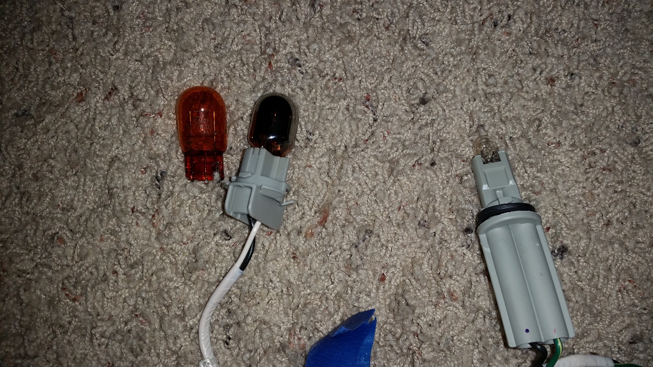

I replaced the orange lamps with these. Be warned they had to be slightly trimmed on the bottom to fit, but not altogether difficult to do

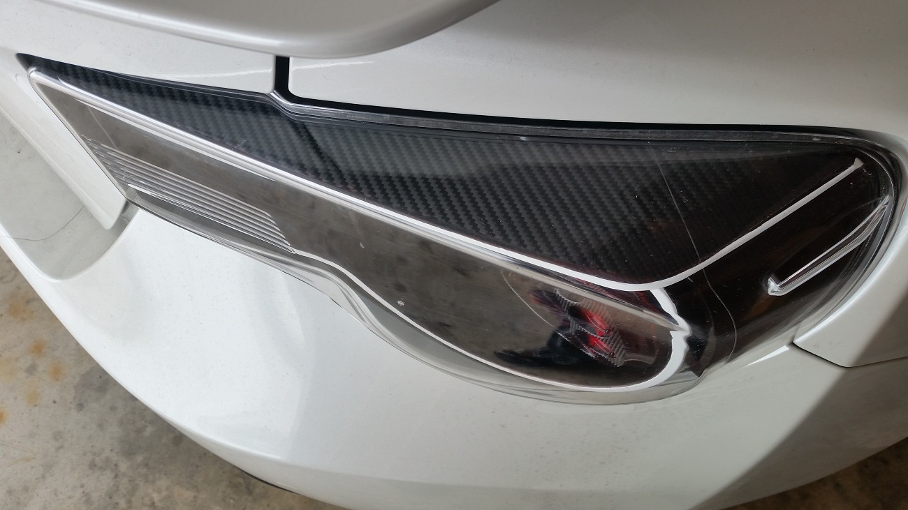

3M carbon fiber vinyl wrap laid on top. I experimented wrapping different sections but in the end just kept the top. I wanted to stay subtle.

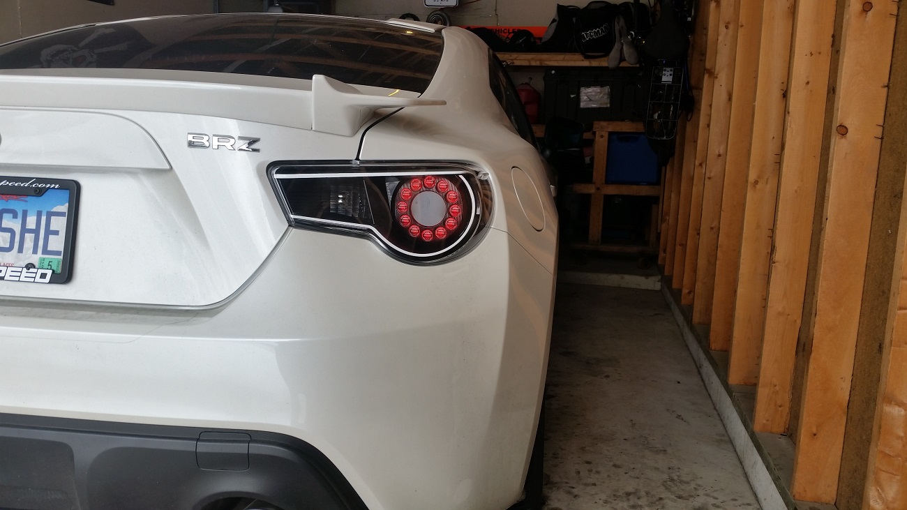

Attachment 96109
Only one side installed currently, I'll add better day and night pics once completely finished.
Attachment 96110
The cf vinyl can only be seen up close, wrap it or don't!

ducky369 11-20-2014 05:18 PM
Did you really just use dimes to cover up those LEDs when painting your brake lights?
poorsche 11-20-2014 05:29 PM
No, pennies
ducky369 11-20-2014 05:30 PM
They are a perfect fit?
poorsche 11-20-2014 05:46 PM
Perfect fit. When the paint dries, flip the light over, the pennies fall out and you have perfect red circles in their place.
