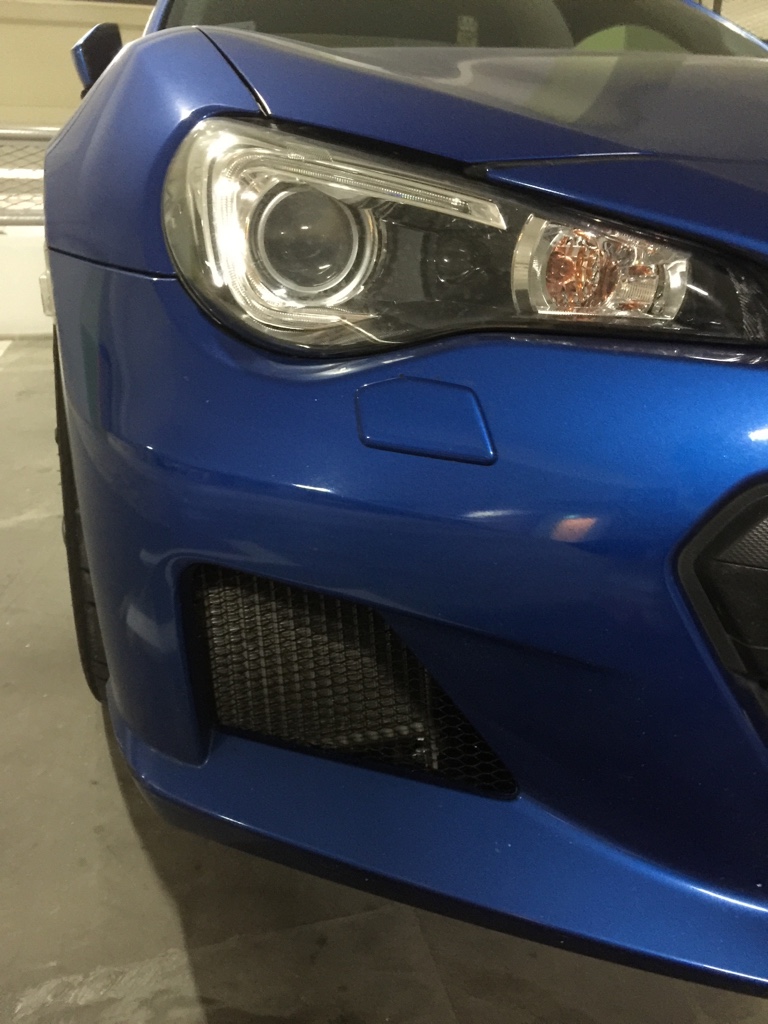

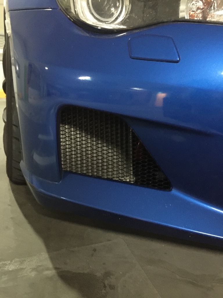

liquidsky44 10-09-2014 03:56 PM
2 Attachment(s)
Attachment 92955
Attachment 92956
This is what I have as well with the HKS oil cooler kit.
