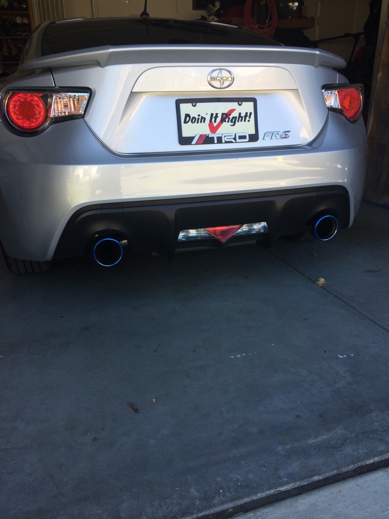

I just recently got an frs and decided to swap the exhaust out. I picked up this q300 exhaust which looks great, but didn't up the sound all that much. Only the high rpms sound better but driving normal doesn't sound any different. What should I do to get a meaner sound?
Jakeval 10-02-2014 12:15 AM
Attachment 92330

Either add a header and/or a front pipe, or get a different catback. The Q300 really isn't much of a step up in terms of sound, you're almost better off staying stock and adding tips while building from header to the back. But it's still a good exhaust to upgrade to (love the tips), adding a UEL header should help out.

The Q300 is a perfect exhaust for those who wish to change the header or other parts of the system. As you replace the front pipe cat or header things get loud VERY quickly. The Q300 is a perfect way of keeping those other future mods in check sound wise.

Thanks for the information. I'll probably lean towards a new header.
