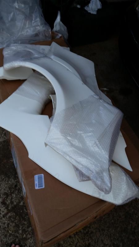

Here is a quick shot of what was in the giant box, minus some packaging.
First impressions is that it is really light. Everything together probably only weights 15 pounds. I don't know how much the real kit weights but maybe someone can chime in. I think the fact that the part is very thin will effect how it rides on the body of the car. Quality seems alright as far as china made FRP parts go. No noticeable imperfections anywhere on it, but you can see that it was hand laid. Surprisingly not as wavy as I thought it would be! I hope through body working and smoothing out the kit, it will add a little rigidity. Putting them up to the car you can tell right away there is small fitment issues. I WOULD NOT RECOMMEND BUYING THIS KIT IF YOU ARE JUST GOING TO RIVET IT ON. Although the kit comes with a huge bag a rivets I feel that the material is too thin and it will chatter against the body and will also not resist damage. I think the fitment will be perfect after I mould it on as the china made kit is a little smaller or shorter in some places, allowing me to create a easy slope to the body when I use fiberglass filler. As oppose to it being perfect to every body line and no room to add a slope at the edges.

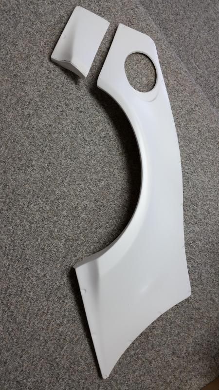

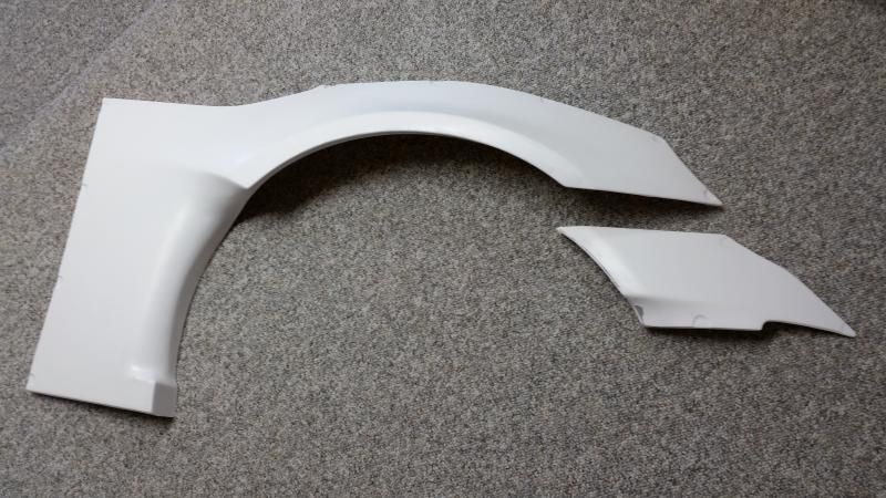

Update! Here's some closer shots of the flares.
http://img.photobucket.com/albums/v6...psf24fe3ec.jpg
http://img.photobucket.com/albums/v6...ps641af0b4.jpg
I should add that these come with some kind of smooth plastic coating with primer sprayed over. The seller gives you a choice if you want white or black primer, I don't think it makes a difference.

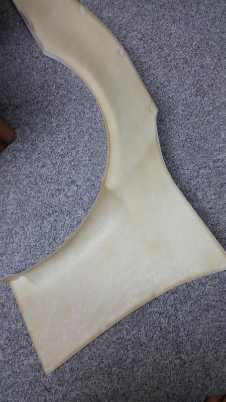

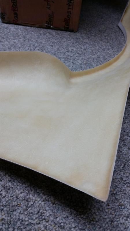

Here is a picture of the back of one of the flares. I only have experience with fiberglass bumpers and side skirts so I don't know what higher quality or bad quality FPR parts look like. I would compare this to what D-Max or Origin 240sx parts look like, about the same thickness and consistency.
