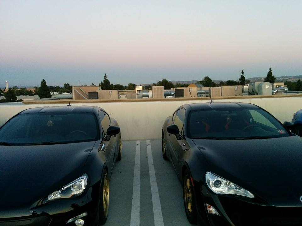

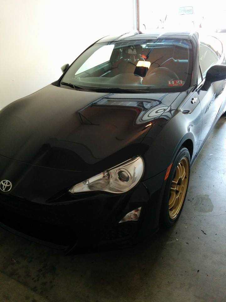

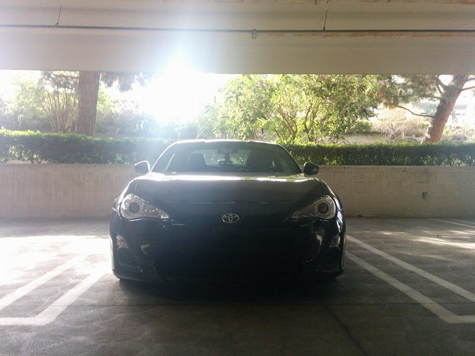

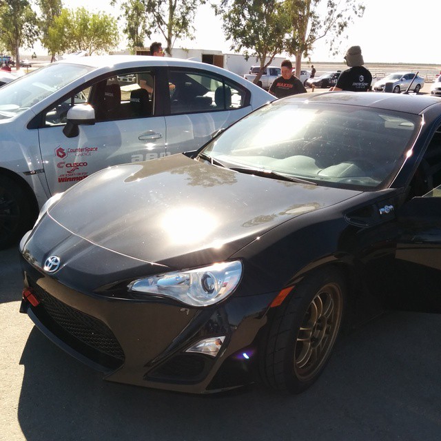

Here are some pics of the car as it is now (and also some pics from before some parts were installed):
Attachment 90221
Twinsies. Even have matching Domo-kuns. :P
Attachment 90222
Attachment 90223
Attachment 90224
